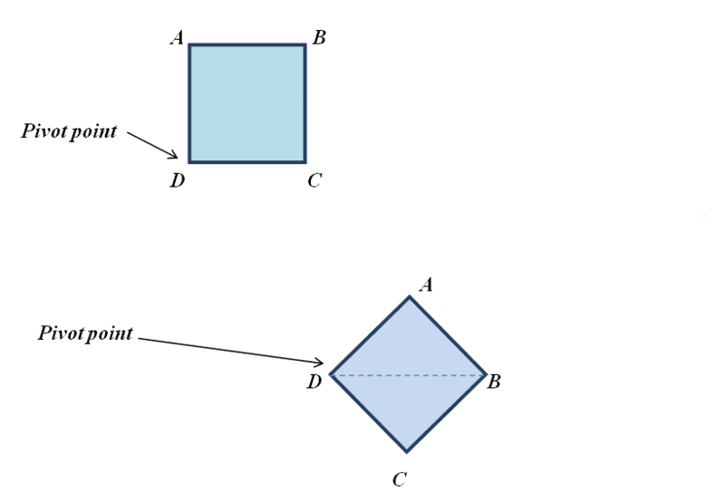

A uniform square plate ABCD has mass 0.8 kg and side length .8 m. The square is pivoted at vertex D and initially held at rest so that sides AB and CD are horizontal (see the diagram). After it is released, the plate swings downward, rotating about the pivot point. Resistive force can be neglected. The acceleration due to gravity is g = 9.8 m/s2. The rotational inertia of a square plate of side d relative to the axis perpendicular to the plate and passing through the center of mass is md^2/6.
Find the rotational inertia of the plate relative to the axis of rotation.
Find the angular speed of the plate at the moment when BD is horizontal.
Find the linear speed of B at the moment when BD is horizontal.
Find the linear speed of B at the moment when B is at the bottom position.

But either way, h would not be 0.6 m for the second question. Did you draw a picture showing the orientation of the square at the moment of release and then another picture for when BD is horizontal? Be sure to mark the center of mass in each case.
Since a diagram wasn't included, I am interpreting the geometry as best I can from the wording of the problem.
OK, now I see the picture. I had misinterpreted it. I thought that initially point B was directly above D so that BD would be a side of the square. But, BD is a diagonal of the square. So, if the length of a side is 1.2 m, then I agree that h would be 0.6 m for the second question. Sorry about that.

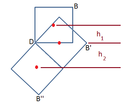

(A) How far does the center of mass move downward in going from question 1 to question 2?
(B) How much additional distance does it go down in going from question 2 to question 4?
It looks to me that you probably have the correct answer to (B) but not the correct answer to (A).

I agree that h1 = .4 for the first part. I don't agree that h2 = .4+ sqrt(2)/2*.8 for the additional distance from question 2 to question 4.

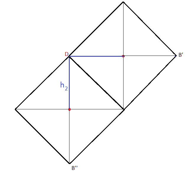

No. See the attached diagram. As corner B moves from B' to B'', the center of mass moves downward a distance h2. You can see that h2 is half the diagonal of the square.

Ok so for part 4 h= sqrt(2)/2*.8, right?
