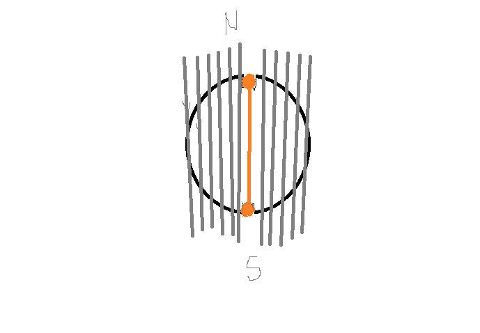

Consider the diagram below (sorry for the quality:frown:). The circle is the front view of a cylindrical iron rotor (highly ferromagnetic, very low reluctance). The orange part is a single turn of a conductor (very high reluctance) wound around the rotor body. The grey lines are magnetic field lines from external magnetic poles, which you can see are crowded in the ferromagnetic iron body. The number of lines actually cutting the conductor is negligible compared to the those in the iron body because of very high reluctance of the conductor. (This is similar to what happens in a practical dc machine.) Now, keeping the magnetic field stationary, if the rotor is rotated through 90°, there will be a "change of flux" associated with the conductor loop. This should induce an emf in the loop as per Faraday's law E=dΦ/dt. But since the conductor is actually cutting a negligible number of magnetic field lines, the motional emf should be almost zero. What am I missing? Please help..
It's a little hard to follow your diagram, but just a guess is that the axis of rotation of the loop is horizontal (and not vertical) so that the ## d \Phi/dt ## is quite large.
It looks me as if when the rotor turns through 90 degs, the conductor has passed through all the lines of force you have drawn. It seems to act like a much bigger loop but without an iron core.
Yes, dΦ/dt is large and should induce an emf. But since the rotor is actually cutting "very few" magnetic field lines due to its high reluctance, motional emf should be almost 0. Hence, motional emf is not equal to dΦ/dt, which contradicts Faraday's law.
How does the rotor "cut" all the magnetic lines? It has a very high reluctance, hence, most of the magnetic lines bypass the conductor and are crowded in the iron body.

Well, I guess my diagram is hard follow.
The grey lines are magnetic field lines which are "bypassing" the orange conductor loop because of its high reluctance. So, there are very few field lines going "through" the conductor. But when the conductor loop is rotated through 90 degrees keeping the external field as it is, the loop will experience a change of flux. In the new position, the loop will be horizontal and "all" the flux will be linked with it while in the initial vertical position, flux linking with it was 0. This should induce an emf in the loop as per E=dΦ/dt.
But since there are actually very few lines going through the conductor, the the flux "cut" by the conductor will be very small. So motional emf Blvsinθ will be very small and since motional emf≠ dΦ/dt, this contradicts Faraday's law.
Still don't see the problem. The magnetic environment of the loop changes, therefore emf is induced. That is Faraday's law.
How many field lines are "cut" is irrelevant. Those lines are just a visual aid.
Perhaps the problem is not stated clearly, try restating without using the metaphore of cutting field lines.
The problem that you are having here is that your concern is based on a false premise. Like other posters, I am not a big fan of the "field lines" for any purpose other than textbook illustrations. However, if you like the concept and want to use it then you must correctly understand and use the rules that govern their behavior.
Magnetic field lines are closed loops, regardless of any material properties like reluctance. The density of lines is proportional to the flux. Consider a wire, a surface bounded by the wire, and a single line of flux. There are exactly three possibilities:
1 The line of flux does not intersect the surface, so there is no flux from that line.
2 The line of flux intersects the surface once, so there is flux from that line.
3 The line of flux intersects the surface twice, so there is no net flux from that line.
You cannot go from either case 1 or case 3 to case 2 without the wire cutting a line of flux. So if the flux changes then you are guaranteed that a line of flux cut the wire. This is contrary to your assertions that few lines are cut. In fact, many are cut, corresponding to the increase in flux.

Ok..Here's a quick description of the diagram..
The conductor (orange) is made of copper (high reluctance) and the rest of the core is made of iron(highly permeable, negligible reluctance). Now, if the magnetic poles are created as shown (using electromagnet), most of the field lines (grey) will bypass the conductor since it has a very high reluctance, and will be crowded in the rest of the core. So, magnetic field B at the site of the conductor(orange circles) is very weak.

Isn't the B field at the site of the conductor(orange circles) much weaker than that in the rest of the core?
