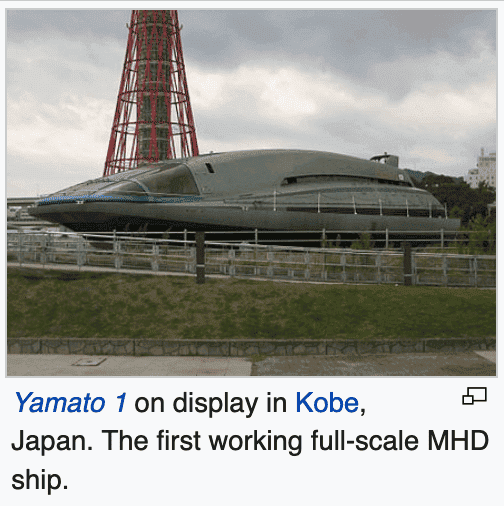

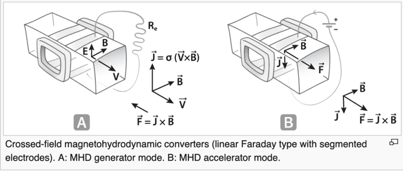

If a conductor moving through a magnetic field generates an emf, which it does, COULD a highly conductive liquid (eg: sea water) moving through said field (like a magnetic flowmeter measuring flow rate is used) generate and would it be enough to be useful?
There is a different, but closely related situation (magnetohydrodynamic drive or MHD accelerator), where magnetic fields are used to propel ships with no moving parts:
Some one who knows more about this stuff could give a better explanation of this than I could.
The Russian sub in "The Hunt for Red October" was supposed to be powered by something like a magneto-drive.
