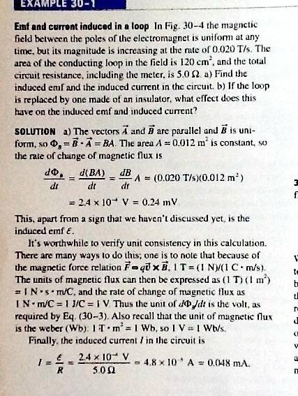

In my examples on Faraday's law in my book, they use a drawing of a magnet approaching a circular wire. The changing magnetic flux then induces an emf on the circle of wire, which in turn causes a current to flow.
I'm wondering if a current will flow in that wire without it having an element to provide resistance, or if it's just drawn that way for simplicity. Perhaps the internal resistance of the wire itself is good enough.

The original post relates to a magnet approaching a circular coil.
If the coil is a single loop having a resistance of 1ohm and the area of the loop is 1 square metre and it is experiencing a changing flux of 1tesla/sec is the induced emf simply 1volt and the induced current simply 1Amp?
If there is a gap in the wire the emf will still be 1 volt but the current will be zero?

My answer in post 26 is correct! This is an elementary Faraday's law calculation as seen in textbooks. (e = -d∅/dt)
I have followed the previous posts closely and got as far as calculating L and C for a loop of wire with a gap (quoted in post22) but then reached a dead end because of some uncertainty about ω.
Are you sure that you are not confusing the original post with AC anaysis?

My answer is correct. This is a standard textbook elementary example and exam question !
I think you are confused with AC circuit theory and the application of Faraday's law.
The induced emf comes about as a result of a changing magnetic flux linkage and I think you have taken this induced emf as a voltage applied to an L, C, R circuit.
I have not seen anything like your analysis in any of my textbooks and there is plenty of experimental evidence that the values in my calculation are correct.
Can you give me a reference where your explanation, especially the equation, is published so that I can check it?
I can't believe that all of my textbooks are mistaken !

It should not matter who I am. This is an elementary A-level question so nothing more than A-level is needed to get the answer.
If you cannot agree that, using the values quoted above, emf = 1 volt and current = 1Amp then you are in serious disagreement with A-level teaching and A-level textbooks.
Whatever you do...do not criticize teachers or the textbooks they use! If the answer is correct at A-level...it is correct.
If you do not agree with the calculation then I urge you to give an answer to this question. There are countless examples in a whole range of physics textbooks.

Do you accept that explanations and answers to questions should conform to textbooks used in teaching?
The question I posed, and I believe the original post refers to, is a standard A-level type question with a very straightforward answer given in all A level textbooks.

The equation v = -N*d∅/dt is a broad statement. What is "∅"? It is not only the external flus linking the loop, but the loop's own internal flux as well. Look up "inductance" and see for yourself.
As long as the loop has L, which it must have, a portion of the total flux inside the loop area will be due to its own self inductance L. This affects "v". Otherwise conservation of energy is violated. If I = Voc/R, with no regard to L & C, you're saying that a copper loop with heavy wire, 0.001 ohm R value, with Voc - 1.0V, will result in 1000 amp??!? I don't think so. If a superconductor is used, what is the current technician?
Your references do not go into the depth of detail needed for these questions. Any EE w/ a motor theory background knows what I'm saying.

You are wrong.
I have no more to add...going round in circles

If I am wrong, please inform us where I went wrong. I know it's been 7 weeks, but it takes more than just telling someone they are wrong to prove them wrong. Please examine the following and state where you disagree.
A wire loop immersed in a time-varying magnetic flux, ∅, will incur induction. The loop has a resistance R, and an inductance L, and if open, the gap will determine a capacitance C. Each quantity, R, L, and C, will contribute to the loop total impedance value Z.
Z = R + jXL + 1/jXC.
When open circuited, the voltage is measured and denoted as "Voc". When short circuited, current is measured and denoted as "Isc". Unless the gap is very small, the area of the wires is generally too small to result in substantial capacitance. At low and medium frequencies, "XC" can usually be neglected.
So to simplify things, we can approximate loop impedance Z as the following:
Z = R + jXL. Of course, XL = ωL. So then:
Z = R + jωL, which is expressed in rectangular (Cartesian) form. To express Z in polar form:
|Z| = √R2 + (Lω)2, angle Z = arctan (Lω/R).
When loop is open, Z is infinite due to gap in wire so that V = Voc, I = 0. When a loading resistance Rload, is placed across the gap in the loop, what is the measured V & I at the load?
There is a voltage divider here. If Rload >> Rwire, we still have to deal with XL = Lω.
Ignoring Rwire, Vload is as follows:

here is a worked example from Young and Freedman (it is a very common example!)
If anything is wrong with this example then there is something seriously wrong with standard textbooks !
I, personally, am not going to reproduce standard textbooks here...they are available for all to refer to.
This answers the original post.

The author assumed that XL << R, so that would be correct only under that specific condition. The motor/generator texts specifically include XL in the equivalent circuit and use this for calculations. I will post an illustration tonight, but I will start a new thread so we can elaborate w/o bothering this thread.
By the way, the Nelson & Parker is the book I looked at. Some of the contributions were made by college instructors, some were high school, and one contributor was a grammar school instructor. BR.
Claude

cabraham said:
The author assumed that XL << R, so that would be correct only under that specific condition. The motor/generator texts specifically include XL in the equivalent circuit and use this for calculations. I will post an illustration tonight, but I will start a new thread so we can elaborate w/o bothering this thread. BR.
Claude
I look forward to your new thread. I am happy that this one is finished.
'THE AUTHOR' = all authors
Ps the induced emf is sometimes called a 'back emf' and the induced current ( if there is one) is sometimes called an eddy current.
It is worth reading about these, their relative directions (Lenz's law) and energy conservation
