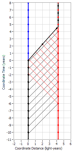

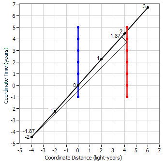

The way to measure distance is with a laser range finder or a radar range finder. In this case, the space man could send out a radar signal when he leaves Earth and measure with his on-board clock how long it takes for him to receive the echo. He assumes that the signal took the same amount of time to get to the star as it took to get back to him and that it traveled at the speed of light in both directions. This allows him to establish how far away the star was at a particular time in his trip. When he gets to the star, he can establish the speed of the star and he can calculate how far away it was when he started his trip.
A spacetime diagram will help. Here is one showing the Earth in blue, the star in red and the space man in black, along with his radar signal and its echo (you have to look very carefully just before the second black dot). The dots represent one-year increments of elapsed time on each clock. This is for the mutual rest frame of the Earth and the star. The space man is traveling at 0.8945c. I have shown his path as extending past the star so that you can easily estimate his travel time, according to his on-board clock at 2.1 years:
As you stated, in the Earth/star frame, it takes him a little over 4.2 years to get there, namely 4.7 years.
The echo of the radar signal that he sent when he left Earth arrives back at him at his time of just under 2 years, we'll call it 1.98 years. He divides that by two and establishes that the star was 0.99 light-years away from him at his time 0.99 years after he left Earth. When he arrives at the star at his time of 2.1 years, he calculates that it took 2.1-0.99=1.11 years for the star to travel 0.99 light-years toward him during the final part of the trip. This calculates to a speed of 0.892c (close enough for our eye-balling off the graph).
Now he can calculate where the star was when he left Earth by multiplying his time interval between Earth and star by the star's speed, 2.1*0.892=1.87 light-years. But to see this, we have to transform all the coordinates of the events in the above diagram to his rest frame during the trip:
Does this all make perfect sense to you? Any questions?

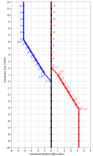

PAllen said:
The practical way to measure distance to an object speeding towards you is radar, as has been suggested. Starting long before Earth passes you at high speed, you are sending out signals to the far away planet (encoded with their transmission times, for simplicity). You note when the Earth passes you, then you note when you receive a signal (from the distant planet) whose transmission time compared to reception time is twice as far back as when Earth passed. Half this time difference times c is your radar measurement of how far apart Earth and the planet were at the time Earth passed you.
We can illustrate this in a spacetime diagram, in fact a couple. This scenario assumes that the space man did not actually leave Earth but was approaching Earth from a long distance away and passing by Earth on his way to the star (or planet). We want to show how he establishes how far away the star was at the moment he passed Earth according to the space man's inertial rest frame. In order to do this correctly, we have to make sure the space man is also inertial, that is, he is not changing speed or direction. As PAllen said, the space man is continually sending out coded radar signals (so that he can match them up with their echoes), keeping track of when they were sent, then detecting their echoes and keeping track of when they were received. Some time later, he goes through his log of data and averages each sent time with its matched echo time. Then he looks for the average time that corresponds to when he passed Earth and takes the difference between the echo time and the sent time and divides that by two and calculates how far light would travel in that time.
So here is a diagram showing the one radar signal sent with its matched echo whose average time equals the time he passed Earth:
Since he passed Earth at time 0, we can see that the average of -1.87 and 1.87 is also 0 and the distance to the star is 1.87 light-years in his inertial rest frame. It doesn't look like it in the above diagram because that is the Earth/star inertial rest frame.

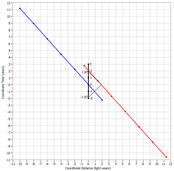

But we can transform all the coordinates of the above diagram to the rest frame of the space man and we get:
Now we can easily see that the star is 1.87 light-years away from Earth when the space man passed the Earth according to the Earth/star inertial rest frame.

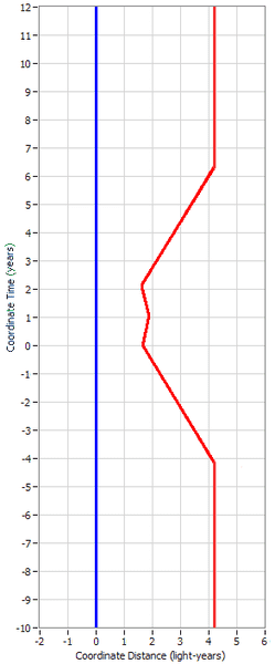

lowemack said:
How does a spaceship log fewer miles, how can you tell it is the distance that got shorter and not you arriving quicker than faster than light travel would allow.
How would you be able to tell when you arrive at Alpha Centura in 2.1 years that the distance you traveled was less and you didn't travel faster than light, because at the end of the day you arrived at something that was 4.2LY away in 2.1 years, from your point of view.

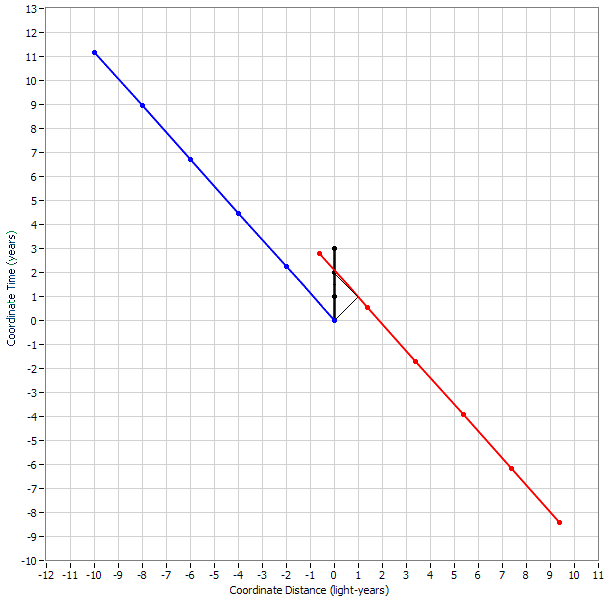

In the previous post I showed how an inertial space man would establish the distance to the star at the moment he passed the Earth.
But what about a space man who was on the Earth and then took off for the star? Does this mean that the star was 4.2 light-years away from him the moment before he left and then 1.87 light-years the moment after he left? Well now we have to consider the rest frame of a non-inertial observer and there is not a standard way to do this so we are free to pick whatever scheme we want to answer the question. I personally like to use the same method that the inertial observers use, which is the radar method. The non-inertial space man does exactly what the inertial space man does but he will get a different set of data and will draw different conclusions.
To begin with, here is a spacetime diagram showing some of the radar signals (the thin black lines) sent by the space man and their echoes (the thin red lines):
Here is a log of the data the spaceman collects:

After the space man arrives at the star, he can calculate the distance to the star as a function of his own Proper Time and he will get this diagram of his non-inertial rest frame or as you said, his point of view:
Note that when the trip starts at his Proper Time of 0, the star has already started moving towards him so that it is much closer (actually 1.6 light-years away) than its starting distance of 4.2 light-years according to this particular way of establishing the non-inertial rest frame of the space man. Note that this gives a different distance than the inertial Earth/star rest frame in the previous post (which was 1.87 light-years).
Hope this helps. Let me know if you need more explanation or have any questions.

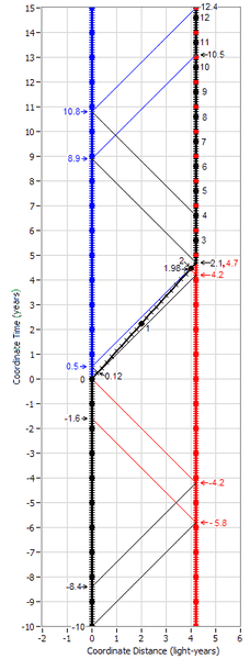

Would the spaceman still get the same distance (2.1LY) if he tried to measure the distance he traveled away from Earth by using this method of radar/laser echo?
lowemack said:
Thanks ghwellsjr. Great explanations that help a lot.
The scenario is symmetrical so whatever distance he measures to the star as he is traveling toward it will be the same distance he measures to the Earth as he travels away from it. However, the distances are changing so they both are functions of his time and although there are moments when those distances are 2.1LY, that particular distance is not significant.
I think you probably meant to say one of the shorter distances that I calculated for you in post #17 (1.87LY) or in post #18 (1.6LY). Why are there two different answers? Because they are measuring two different things. The first one is the distance between the Earth and the star in the inertial rest frame of the spaceman during the trip. This distance is a constant so that when he is colocated with the Earth, the star is 1.87LY in front of him. Later, when he is colocated with the star, the Earth is 1.87LY behind him. This distance also corresponds to the simple formula, distance equals speed multiplied by time. Since he calculated his speed at 0.892c and his travel time is 2.1 years, he gets 1.87LY.
However, you are trying to reconcile the fact that before the spaceman started his trip and after he finished it, the distance between the Earth and the star is a different constant, 4.2LY according to their mutual rest frame so it seems that he is traveling double the speed of light since it took him only 2.1Y of travel time. But if we actually carry out the radar measurements that he performs in establishing his own non-inertial rest frame, we see that the star begins moving toward him long before the Earth starts leaving him and the Earth continues moving away from him long after the star reaches him. That is what I want to show you now.
In order to do this more clearly than I did in my previous diagrams, I'm adding tick marks every tenth of a year and labeling the dots that are spaced one year apart when they don't coincide with the Coordinate Time. I'm also labeling the tick marks corresponding to the sending of a radar signal, the point of reflection and the receiving of the radar echo. And I'm showing a minimal set of radar signals and their reflections at strategic points along the scenario. These points are whenever there is a change in the spaceman's trajectory for either sending the radar signals or receiving their echoes. And then I need another pair of radar signals at the beginning and at the end.
This spacetime diagram is an extension of the first one in post #18:
There are two sets of logs that the black spaceman keeps, one for radar signals sent to the red star and one for radar signals sent to the blue Earth. Here is the one for the star:

Note that I have added into the above two logs the calculations that the spaceman makes from his radar data to establish the Time and Distance to the star and the Earth. Recall that the Calculated Time is the average of the Sent Time and the Received Time and the Calculated Distance is one half of the difference between the Sent Time and the Received Time multiplied by the speed of light which in our case is 1.
From the above calculations and the observed time on the clock of the star and the Earth, the spaceman can construct his non-inertial rest frame. Note that he has to linearly interpolate the worldlines between the calculated events and add in the appropriate number of dots and tick marks based on the deltas between the observed Proper Times from the star or from the Earth:
I didn't draw in the radar signals but if you want, you can print the diagram and draw them in yourself, just remember to draw them at 45 degree angles. You will see that the radar signals, their echoes and the Proper Times of reflection follow the same patterns as they did in the first diagram in this post.
You can see from the above diagram that the star starts moving at just over 0.6c toward the spaceman 4.2Y before the Earth starts to leave the spaceman so that it happens to be 1.6LY away when the Earth starts to move. The Earth moves away at 0.8945c for 1.1 years according to the spaceman but it ages only 0.5 years during this time. Meanwhile, the star is moving just over 0.6c and continues until the spaceman has reached one year. At that point, the speed of the star goes up from 0.6c to 0.8945c so that in the next 1.1 years for the spaceman, the star has aged 0.5 years. There is an overlap only of 0.1 years from the spaceman's time of 1.0 years to 1.1 years when the speeds of the star and Earth are identical and the distance between them is a constant, 1.87LY, the same distance that they are separated in the inertial rest frame of the spaceman during the trip (see post #17). Here is a spacetime diagram zoomed in on this portion of the overlap so you can see the measurements more clearly:
After this period of time, the spaceman becomes colocated with the star while the Earth continues to move away at just over 0.6c. Finally, at the spaceman's time of 6.3 years, the Earth comes to rest 4.2LY away from the spaceman who has been colocated with the star for 4.2 years. Note in the diagram two above that the Proper Times for the star and the Earth have once again become synchronized with each other and ticking at the same rate as the spaceman's clock but he has lost 2.6 years because in the star/Earth rest frame (first diagram above) his trip took 4.7 years but his clock only advanced 2.1 years. For example, if you look at the second diagram in this post at the red dot labeled 10 (years), the Coordinate Time is 7.4 years which is the same at the spaceman's Proper Time and that gives us a difference of 2.6 years, the amount of time the spaceman lost during his trip according to the clocks synchronized in the star/Earth rest frame.

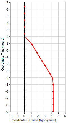

Now I have one more diagram to show you, the distance between the star and the Earth according to the spaceman's non-inertial rest frame:
The important point to notice about this diagram is that it shows that the distance between the star and the Earth is 1.6LY at the beginning (0 years) and ending (2.1 years) of the trip but in between it is 1.87LY for 0.1 years (from 1.0 years to 1.1 years) according to the radar method of establishing a non-inertial rest frame.
