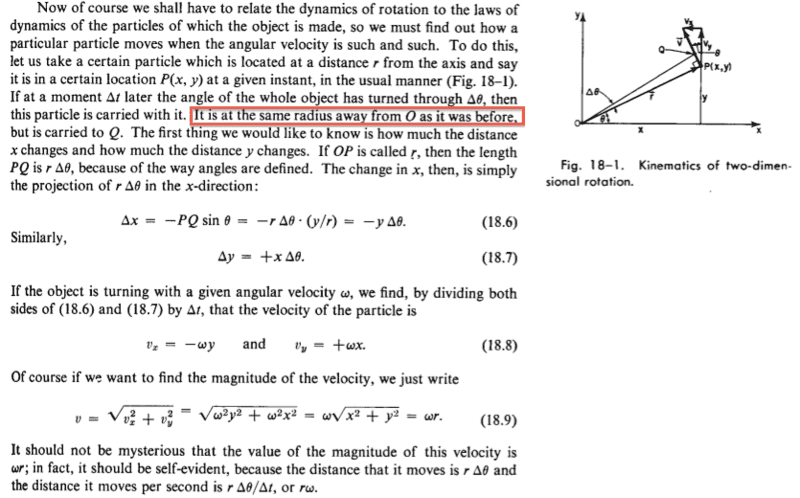

This isn't really a 'problem', I'm just trying to follow Feynman's reasoning in section 18-2 of Volume 1 The Feynman Lectures on Physics. I've attached a png of the paragraph in question.
I have 2 issues with this:
1. If the length OQ = OP, how can there be a right angle at P(x,y)?
2. I don't understand why QP = r \Delta\theta, rather than r * tan (\Delta\theta)
Am I missing something? I've checked the latest errata and this isn't mentioned.
Because that's the way these ∆s work …
we ignore anything that's small compared with a ∆ (in the same way that we ignore dh2, compared with dh, when we do calculus proofs)
So ∆θ = sin∆θ = tan∆θ. :wink:
(sin∆θ = ∆θ - (∆θ)3/3! + …)
Ah yes a Taylor series. Mathematics back in the days of the slide rule I suppose. Now we don't bother with simplifications as much. Cheers! How about the right angle?
