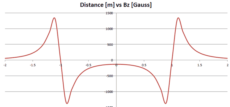

Hello,

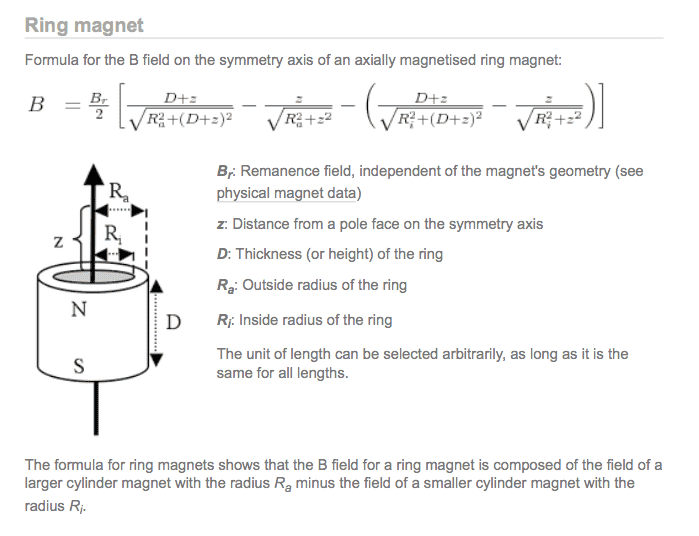

I'm trying to find an equation which describes B(z) inside of a permanent ring magnet that is axially magnetized. Also, depending on if the equation holds true, if the ring magnet will behave as a magnetic mirror.
Below is an equation which describes the axial field of such a magnet, however I believe the equation is only valid when considering a distance starting from the ending face of the magnet.
Reference diagram titled Ring magnet giving the on-axis B field formula for an axially magnetised ring, with a cylinder diagram labelling N, S, z, D, Ra and Ri.
When I use this equation for a magnet with the parameters shown below, here is the field which is visualized.
Parameters:
Br 12000
Thickness 0.1 [m]
R(out) 0.18 [m]
R(in) 0.1 [m]
Its important to note that I shifted the graph below by .05 [m] to center the ring magnet at the origin.
Line graph titled Distance [m] vs Bz [Gauss] showing Bz against distance from -1 to 1 m: small positive peaks near 500 at about -0.18 and 0.18, a sharp negative dip to about -2150 at 0, and near zero at the ends.
I'm surprised to discover that the field inside the magnet actually flips directions. I thought perhaps the equation shown above which describes this field, was inaccurate inside the magnet. But then I found this picture.

My questions are, does anyone have experience solving the magnetic field for a ring magnet, and can confirm that indeed the equation listed above works for all space?
And considering plasmas or charged particles, when approaching the inside of the magnet where the field grows, would this serve as a magnetic mirror in some sense?
If the charged particles are not reflected from the increasing magnetic field before reaching the inside of the magnet, will they be accelerated by the abrupt change in magnetic field? Or will they be reflected as the charged particle continues towards the center of the magnet. Perhaps even trapped between the regions where the field direction abruptly changed?
The magnetic field as shown in the picture, going down the opening in the center of the magnet, (and opposite the direction the field would be if the hole were filled in with magnetized material), is qualitatively what would be expected from a ring magnet that is not very long. If the magnet were a very long cylinder, the field in the center would be minimal. A " magnetic surface current" modelling of the magnet is how these conclusions can be reached. (This model ignores any magnetic "poles"). The magnetic surface currents (basically moving electrical charges) in the center opening run opposite the direction that they do on the outer surface of the cylinder. The surface currents are basically like the currents of a solenoid.(comes from the formula, surface current per unit length ## K_m=M \times \hat{n}/\mu_o ## where M is the magnetization (assumed uniform in the +z direction, and ## \hat{n} ## is the unit vector pointing normal from the surface. A simple calculation will show these currents have the same geometry as the currents of a solenoid). For a long cylinder, it would be like one solenoid inside the other with currents in opposite directions. The result would be zero field down the center. For a much shorter cylinder /solenoids, the currents of the inner one have more effect at determining the field in the center opening. As for your formula, I'm not particularly familiar with it, but the magnetic surface currents with Biot-Savart's law would get you an answer that you could compare it with.

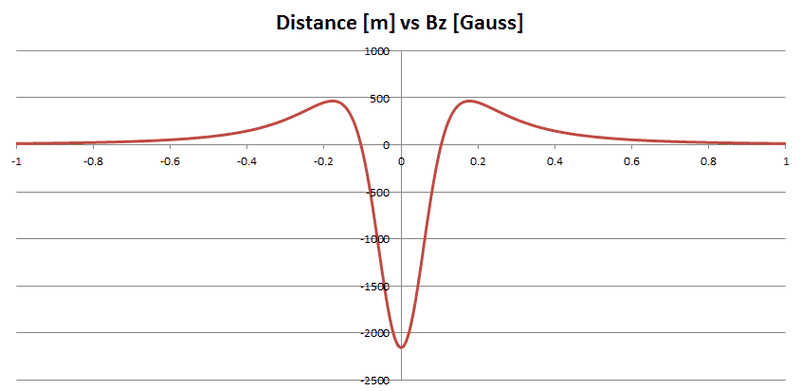

Minimal and opposite in direction? I believe that is also what I am seeing when I extend the cylinder with the same parameters as above, but with the thickness increased from .1 to 2.0 [m]. (Huge magnet)
Line graph titled "Distance [m] vs Bz [Gauss]" with x-axis from -2 to 2 and y-axis from -1500 to 1500. The curve is symmetric about the origin, rising to peaks near x = ±1.1 and dropping to troughs near x = ±0.9, with a small positive value at the origin and tails approaching zero at the ends.
Here I consider a negative value to be in the ##-\hat{z}## direction.
Ahh, so it appears that in fact, this formula that I am using may indeed be correct, or at least you are confirming what I am seeing with this calculation. I am slightly confused when you mention a solenoid has similar surface currents to this ring magnet, as the fields that run normal to the plane of a current loop do not change direction when considering Biot-Savart. But I think I'm incorrectly interpreting what you are saying.

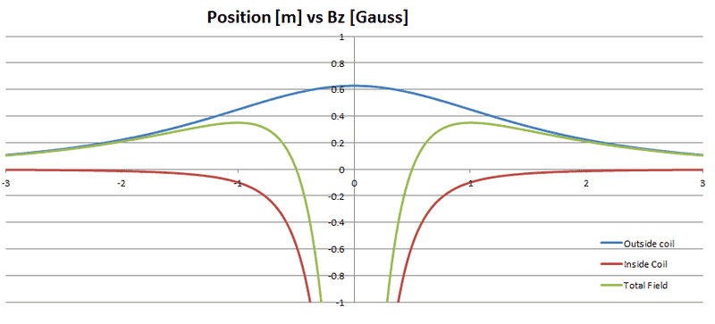

Ok, this is starting to make a bit more sense now, and might explain the original formula posted, as I read somewhere explaining the formula (don't have link now) stating it considers the flux of the outsize radius and subtracts the inside radius. I'm thinking of two solenoids, one inside the other where current runs opposite relative to each other.
Which is exactly what I see when using a simple model.
Line graph titled Position [m] vs Bz [Gauss] showing three curves against position from -3 to 3: Outside coil (blue) peaks near 0.6 at the centre, Total Field (green) peaks near 0.35 at positions ±1, and Inside Coil (red) stays near zero then drops steeply negative beyond ±1.
Sure enough that looks just like the magnet.

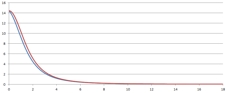

I apologize, I should have been a bit more descriptive.
I meant to say, I thought magnetic fields from a permanent magnets died off as 1/R^3 rather than an electromagnet, as someone mentioned this to me. I had used Biot Savart for the last graph which should show the fields die off as an inverse square.
Just to make sure, I did a comparison where the field strength is similar at the edge of a very thin permanent magnet vs a vary thin wire where both have the same outer diameter and the permanent magnet is essentially a disk
Line graph of two curves, a blue and a red, both starting near 14 on the vertical axis at x = 0 and decaying toward zero by about x = 10, with the red curve lying slightly above the blue.
It appears the fields die off relatively the same. However when the disk becomes more of a ring, then the field dies off much more quickly in the "near field".
If you'd like to continue discussion or check with any kind of modeling that would be great!
