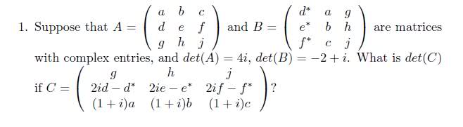

Hi, right now I have two 3x3 matrices with letter entries, I know the determinant of A and the determinant of B, and I am given a matrix C for which I have to find the determinant for. Right now I am expressing matrix C as a combination of A and B, but what happens to the determinant when I add matrices A and B together?
Homework problem: matrices A and B with letter entries shown, and matrix C with entries like 2id - d*, 2ie - e*, 2if - f*, and (1+i)a, (1+i)b, (1+i)c in its bottom row, with det(A) = 4i and det(B) = -2 + i.
One of the rows of C is a linear combination of two vectors. det is linear in the row entries, right?
Well all the rows in C are a linear combination of vectors in A and B.

I'm referring to the second row being a sum of two vectors.
Ok, that's true, but how does that help me in finding the new determinant? I still have to know what happens when I add the matrices together, unless you mean something else?
I mean that if the letters A, B, C, and D are row vectors then det(A,B+D,C)=det(A,B,C)+det(A,D,C). det is linear in the row vectors.
But wait I don't understand how that works...why do the B and D add but nothing else...isn't this sort of like saying det(A+B)=det(A)+det(B) which isn't true?

No, it's not the same thing. I'm using that det is a multilinear function of it's rows (or columns). It's a fundamental property of the determinant. Try and find it in your book. It's important.
