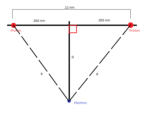

The hydrogen molecular ion H1,2, with one electron and two protons, is the simplest molecule. The equilibrium spacing between the protons is 0.11 nm. Suppose the electron is at the midpoint between the protons and moving at 1.5 * 10^6 m/s perpendicular to a line between the protons.
How far (in nm) does the electron move before reaching a turning point? Because of their larger mass, the protons remain fixed during this interval of time.
PE = kQq/r
KE = 1/2 mv2
W = KE + PE
k = 9*109
I first drew a diagram to get an idea of how to approach this problem.
Let x2 = .055 nm
R = √(D2 + x2)
-ΔKE = ΔPE
-(-KEi) = PEf
1/2 mv2 = kQq/R + kQq/R = 2kQq/R
R = 4kQq/(mv2) = √(D2 + x2)
D2 + x2 = [4kQq/(mv2)]2
D = √( [4kQq/(mv2)]2 - x2 )
D = ~.447 nm
This answer, however, is wrong. The correct answer is 3.0 * 10-3 nm.
I tried integrating from F, but I still found the same equation for PE. Am I doing something incorrect? Please help as I need to know this by tomorrow for my midterm. Thank you for any help received!

PE+KE = const. The potential energy is not zero at the midpoint. Change of potential energy= final KE.

So the set-up should be
PEf - PEi = KEf
2KQq (1/R - 1/x) = 1/2 mv^2 ?

The problem states that the electron travels in the path of a perpendicular bisector of an imaginary line connecting the two protons. If you were to find the radius of that, then it'd be half of the length of the line squared plus the distance traveled squared under a radical. Rather than saying Sqrt( L^2/4 + D^2), it seemed cleaner to say Sqrt( x^2 + D^2) and make x = (1/2)L, L being the length of the line connecting the two protons.

So I have something like this:
2kQq(1/R - 1/x) = 1/2 mv2
(x-R)/(xR) = (mv2)/(4kQ2) <--- because Q=q=1.6*10-19
(xR)/(x-R) = (4kQ2)/(mv2)
mv2xR = 4kQ2x - 4kQ2R
(mv2x + 4kQ2)R = 4kQ2
R = (4kQ2)/(mv2x+4kQ2)
√(x2+D2) = (4kQ2)/(mv2x+4kQ2)
D2 = (4kQ2)/(mv2x+4kQ2)2 - x2
D = √[(4kQ2)/(mv2x+4kQ2)2 - x2]

The set up is supposed to be
KEi = PEi - PEfBUT it should look like this:
-2kQq(1/R-1/x) = 1/2 mv2
2kQq(1/x-1/R) = 1/2 mv2 because Q (the source charges) is 1.6 * 10-19 while q = -1.6 * 10-19
(R-x)/(xR) = (mv2)/(4kQ2)
(xR)/(R-x) = (4kQ2)/(mv2)
mv2xR = 4kQ2R - 4kQ2x
(mv2x - 4kQ2)R = 4kQ2
R = (4kQ2)/(mv2x-4kQ2)
√(x2+D2) = (4kQ2)/(mv2x-4kQ2)
D2 = (4kQ2)/(mv2x-4kQ2)2 - x2
D = √[(4kQ2)/(mv2x-4kQ2)2 - x2]
Plug everything in, and you should be able to get 3.00131072 * 10^-2 nm

2kQq(1/x - 1/R) = 1/2 mv, as KE(initial)=PE(final)-PE(initial). But qQ is a negative number, so your equation is correct if you use the absolute value for the electron charge.
Previously you called the vertical displacement "x". It is better to denote the distance from a proton by "d", for example.
Do not complicate the calculations. Plug in the data, calculate 1/R-1/x. Do not round too much.
(1/R-1/x) can be also written as 1/R(1-R/x).
ehild

Thank you. As you see above, I found the correct answer. "x" was not set as the vertical displacement, however. Instead, I set "x" as half of the length of the line connecting the two protons and "D" as the distance from the midpoint of the referred line.
I also now see why it is (1/x - 1/R) due to your explanation. As always, you seem to have fully answered my questions without giving away the answers, allowing me to figure out the entire problem. Thank you so much for all the times you have helped me, ehild! :)

Well, sorry, I forgot your notations. The PE(final)-PE(initial)=2kqQ(1/R-1/x) , your equation was correct. But q is negative.
Have you got 0.003 nm really? I could not get the same result...
ehild

Yes I have!
Like you said, since q is negative, the (1/R-1/x) becomes (1/x-1/R) instead.
So,
PEf - PEi = 1/2 mv2
-2kQ2(1/R-1/x) = 1/2 mv2 Since q = -Q
2kQ2(1/x-1/R) = 1/2 mv2
1/x - 1/R = (mv2)/(4kQ2)
(R-x)/xR = (mv2)/(4kQ2)
xR/(R-x) = (4kQ2)/(mv2)
(mv2) xR = (4kQ2)R - (4kQ2)x
[(mv2)x - (4kQ2)]R = -(4kQ2)x
R = -(4kQ2)x/[(mv2)x - (4kQ2)]
Since R = √(x2+D2)
√(x2+D2) = -(4kQ2)x/[(mv2)x - (4kQ2)]
x2+D2 = [ -(4kQ2)x/[(mv2)x - (4kQ2)] ]2
D2 = [ -(4kQ2)x/[(mv2)x - (4kQ2)] ]2 - x2
D = √ ( [ -(4kQ2)x/[(mv2)x - (4kQ2)] ]2 - x2 )
With this equation, I found .003 nm. This was after multiplying the result with 109 so convert from meters to nanometers, of course.
OK, I have found my mistake...
KE=(-2kqQ/x)(1-x/R)
So KE=1.0248˙10-18
-2kgQ/x=8.388˙10-18
1-x/R=0.1222...
ehild
