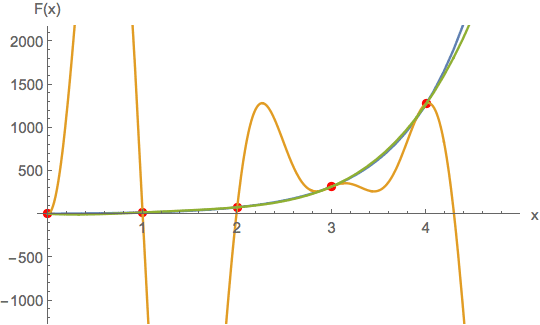

I got $$F(x)=
891.445 \cos(x) + 2752.35 \cos(2 x) + 544.52 \cos(3 x) - 2570.62 \cos(4 x) - 1612.7 \cos(5 x).$$One can always fit ##N## data points to any model with ##N## adjustable parameters. See plot below showing the degree 4 polynomial (blue), the sinusoidal superposition (brown) and ##F(x)=5\times 4^x## (green). All three lines pass through the data points exactly. The simpler model is the exponential and we must choose it by applying Occam's razor.
I extended the plot to include ##x=5## and show that the three lines diverge. If we had ##F(5)##, we would be able to distinguish which one is correct. If ##F(5)## is right on the exponential, @SammyS could add another term to the polynomial and I could another sine making both our models more complex while the exponential would retain its simplicity.
Plot of F(x) against x for x from 0 to 5 showing three curves through red-marked points at x = 0, 1, 2, 3 and 4. A smooth exponential-looking curve and a near-identical polynomial curve rise together, while an oscillating curve swings widely between the points, reaching about 1250 near x = 2.2 and falling below -1000 near x = 4.3.
