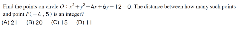

Multiple-choice question: Find the points on circle O: x^2 + y^2 - 4x + 6y - 12 = 0 whose distance to point P(-4, 5) is an integer. Options: (A) 21 (B) 20 (C) 15 (D) 11
Distance between point (-4, 5) and point on circle:
$$d=\sqrt{(x+4)^2+(y-5)^2}$$
$$=\sqrt{x^2+8x+16+y^2-10y+25}$$
Then substitute ##y^2## from equation of circle:
$$d=\sqrt{x^2+8x+16-x^2+4x-6y+12-10y+25}$$
$$=\sqrt{12x-16y+53}$$
After this, I need to try the points one by one to check whether the distance is an integer and also whether the point is located on the circle? I am pretty sure there should be a more sane method to do this
Thanks

I would start by changing coordinates to put the origin at circle center. Then there are only a few right triangles with integer sides. Actually I'll bet you can show it must be an even number,which is all you need for this.

Can you workout the center of the circle? We would get it as (2,-3). And radius?
Take any point on the circle, draw a triangle joining the center, the point (-4,5) and the arbitrary point on the circle (x,y). We know the distance between the point on circle and the center is ##r## (please workout it out) and the distance between the center and (-4,5) is 10 units. With resepct to the angle made at the center in this triangle, can you write out the cosine rule?

First, a change of coordinates to ##\bar x = x - 2, \ \bar y = y + 3## is a good idea.
Then use the symmetry to move the point ##P## to somewhere simpler, keeping the same relationship with the circle.
Then count.
However, as the circle itself has an integer radius ...

No, you only need to check the distance for at most 2 points on the circle. Those being the point nearest to ##(-4,~5)## and the one farthest from ##(-4,~5)##.
How many integers fall between those two extremes?

EDIT DUH!: When you complete the square the quadratic terms are always positive. I wish I could do arithmetic. Thanks.
I got the answer using @hutchphd hint in post#2 but the method I use is not as efficient as @SammyS in post#8

By symmetry, the answer must be an even number.

Rotate the system to put ##P## on the ##x##-axis.

To calculate the answer you need the radius of the circle and the distance between P and the center of the circle. After that the coordinates are irrelevant.
