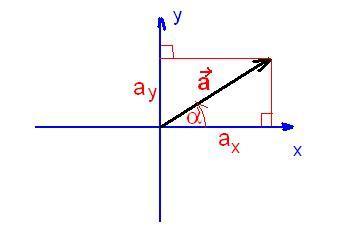

Equilibrant is the opposite of the original vector. The magnitude is the same and it makes an angle of 180° with the original. So its angle is 180°+ the angle of the original vector.
As for vector addition, the simplest way is using the coordinates. They are the projections of the vector to the x and y-axis (ax and ay ). See figure attached.
If you have vector with length a and angle \alpha with respect to the positive x axis, ax=acos(\alpha)
and ay=asin(\alpha)
You get the components of the sum of two vectors a and b by adding the components :c=a+b ---> cx=ax+bx, cy=ay+by.
If you have the components of a vector, the length is √(ax2+ay2)
and tan(\alpha)=ay/ax.
Can I give a piece of advice: no reason to help if your son does not listen to the lectures. He must make notes. Do not try to help without seeing what they learn and how. You might explain on a different way than his teacher does, and you will confuse the boy.
ehild

You can add two numbers without calculator, do you not? Add or subtract 180° from the angle of the resultant vector (so as the result is less than 360°) to get the angle of the equilibrant. The magnitudes are the same.
ehild
