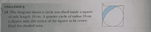

Find the area of the shaded region in the inscribed circle on square
The discussion revolves around finding the area of a shaded region within a circle inscribed in a square. Participants are analyzing various geometric properties and calculations related to sectors, triangles, and segments within the context of the problem.

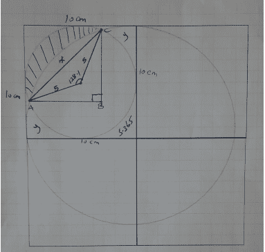

See attached
area of circle
Find the solution here;
Find my approach below;
In my working i have;
##A_{minor sector}##=##\frac {128.1^0}{360^0}×π×5×5=27.947cm^2##
##A_{triangle}##=##\frac {1}{2}####×5×5×sin 128.1^0=9.8366cm^2##
##A_3##=##\frac {90^0}{360^0}####×π×10×10##=##78.53cm^2##
##A_{major sector}##=##78.539-27.947=50.592 cm^2##
##A_{minor segment}##=##27.947-9.8366=18.1104 cm^2##
therefore,
##50.592+9.833+5.365+ 2y+m *= 78.53cm^2##
##65.79+2y+m*=78.53cm^2##
##2y+m*=12.74 cm^2##
Also,
##R_{required region} + m*=18.1104cm^2##
##R_{required region} +2x=16.105cm^2##
Also,
##x+y=5.365cm^2##

We have no way to follow your working (except heavy reverse engineering ?:) ) unless you tell us what is what.
If, with ##A_{\text{minor sector}}##, you mean the red segment EAC, then you have a wrong value for the angle. Where does it come from ?
If, with ##A_{\text{triangle}}##, you mean the red triangle EAC , idem.
##A_3## is a quarter circle. I don't see a reason to subtract ##A_{\text{minor sector}}## ? What is ##A_{\text{major sector}}## ?

Yes, the minor sector is the red segment EAC...
The Area of major sector and Area of the minor sector is equal to the area of the circle with radius ##5cm##. That is;
+ ##A_{major sector}##=##78.539-27.947=50.592 cm^2##
Your CDA is indicated as ##m*## on my equations.
Your ACE is the area of my triangle, ##A_{triangle}##=##\frac {1}{2}####×5×5×sin 128.1^0=9.8366cm^2##Let me check the angle again.

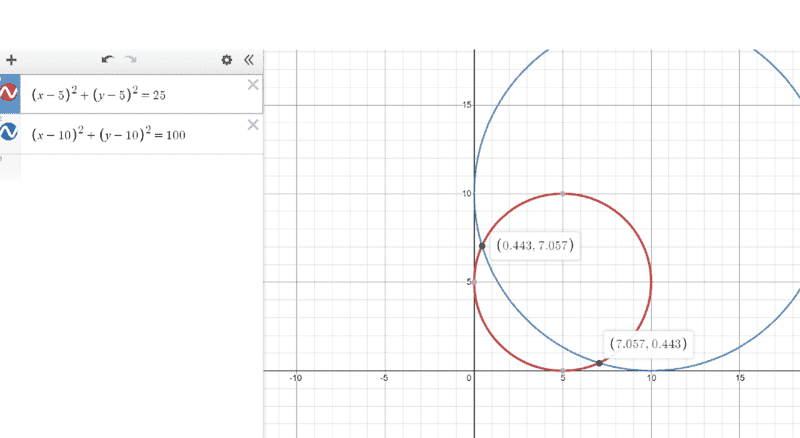

Boss the angle is correct man..consider points which are approximately equal to ##A(0.3, 3.5)## and ##C(7,9.5)##( i.e From my scale drawing) The length ##AC##=##\sqrt{6.7^2+6^2}##=##\sqrt{80.89}##=##8.9938cm## Consider your ##OBED## as a perpendiculor bisector then we shall have an isosceles triangle with equal sides =##5cm##. Applying pythagoras thereom should realize
##sin θ## = ##\dfrac{4.4969}{5}##
##θ=sin^{-1} 0.89938 =64.0766^0##
The required angle is ##64.0766^0 × 2 =128.15^0##

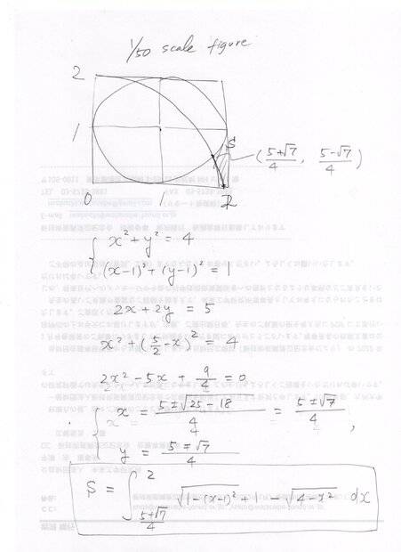

I try integration as attached.
[EDIT]
Correction : scale 1/5
Directly
[tex]\frac{A}{L^2}=\frac{1}{4}\int_{\frac{5-\sqrt{7}}{4}}^{\frac{5+\sqrt{7}}{4}}\sqrt{(2-x)(2+x)}-\sqrt{x(2-x)}-1 \ dx[/tex]
where L is side length of square.
Or
[tex]\frac{4A}{L^2}=\frac{\phi}{2} +2 \sin\theta - \frac{1}{2}\sin \phi-2\theta[/tex]
where
[tex]\cos \phi = - \frac{3}{4}[/tex]
[tex]\cos \theta = \frac{9}{16}[/tex]
which come from inner products of radius vectors.
Approximately
[tex]\frac{4A}{L^2} \approx 0.5856[/tex]
For L=10
[tex]A \approx 14.64[/tex]

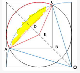

My cumbersome path to solution:
Solve for coordinates of C (and A) to get the angles.
Red segment EAC minus triangle EADC gets me the yellow area:
Segment OAC minus triangle OADC gives me the area to subtract:
and that leaves me exactly 14.638
Your turn.
:smile:

Segment OAC or Sector OAC? Unless i am getting you right ...your shaded region ie Segment ADC is clearly not the shaded region asked for in the problem.
Let me check again.
Let me check again.
Sector, sorry. Not my first language.
What is a segment in your lingo ?
Read. Your exercise wants the first yellow area minus the second.
I saw no reason to repeat the picture in post #1.
Can you set up the equations to find angles CEA and COA ?

You are right on the angle...i had used approximated values instead of the actual values...and that was wrong! on my part! :nb)I will proceed as follows:
##AC##=##\sqrt{6.614^2+6.614^2}##=##\sqrt{87.489992}##=##9.353608502cm##
##sin θ## = ##\dfrac{4.676}{5}##
##θ=sin^{-1} [0.9352]=69.26048^0##
The required angle is ##69.26048^0 × 2 =138.52^0##...now allow me to proceed to solution of course using your hint! thanks...a minute please.
Directly
AL2=14∫5−745+74(2−x)(2+x)−x(2−x)−1 dx
Charles Link said:
One comment is I think post 4 by @anuttarasammyak is incomplete as posted, (he does have the correct answer), but the limits on his integral for 4A /L^2 do not cover the entire area of interest. There needs to be a second integral that goes out to x=2 that is added to this to get the entire area.
Thanks @Charles Link. Going back to my handwriting I would correct the integration as
[tex]\frac{4A}{L^2}=3-\frac{3\pi}{4}-2\int_{\frac{5+\sqrt{7}}{4}}^2 1-\sqrt{2-x}[\sqrt{2+x}-\sqrt{x}] \ \ dx[/tex]
@anuttarasammyak The term you need is on the typed portion of post 4 at the bottom, and it is
## 2 \int\limits_{\frac{5+\sqrt{7}}{4}}^{2} \sqrt{x(2-x)} \, dx ##.
