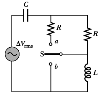

An AC circuit contains a capacitor, an inductor, and two resistors of equal resistance as shown in the figure. The source provides 20V rms at 60Hz. When the switch is open as shown, the rms current is 183mA. When the switch is closed in position a, the rms current is 298mA. When the switch is closed in position b, the rms current is 137mA. What is the value of the capacitor in F?
$$X_C = \frac{1}{\omega C}$$
$$X_L = \omega L$$
$$ Z = \sqrt{R^{2} + (X_L - X_C)^{2}}$$
$$I_0 = \frac{V_0}{Z}$$
You can find the impedance for each of the three positions with V/I. However I'm not sure how to find the inductive and capacitive reactance. Thanks for your help.
Yes, one step is as you say to take the quotient ##{\frac{V_{rms}}{I_{rms}}}## for each of the three cases, but then for each of the three cases you must calculate the impedance in terms of R,L and C. Equate the three expressions containing R,L,C with the three respective quotients and you ll have a system of 3 equations with 3 unknowns the R, L,C.
I can tell you that the impedance ##Z_S## when the switch is as shown is given by the 3rd equation of your OP, where ##X_L,X_C## as in first and second equations of your OP.
What is the impedance(always in terms of R,L,C) ##Z_a## when the switch is on a and what is the impedance ##Z_b## when the switch is on b? Answer these two questions first please.

On a:
$$ Z = \sqrt{(R/2)^{2} + (\omega L - \frac{1}{2C \omega})^{2}}$$
On b:
$$ Z = \sqrt{(R)^{2} + (\omega L - \frac{1}{C \omega})^{2}}$$
For b the inductance is shorted. There is not potential drop on it.

Frankly, I would try to find the value of ##R## first.
What is the difference in the circuit for the open position versus the switch being in position ##a## ?

For a, why you say the reactance of capacitor is equal to ##\frac{1}{2C\omega}##? Does the capacitor change value to 2C?
For b what happens is that the coil is like is not present in the circuit, it is "shorted out" as we say in EE argo. Yes you are kind of right in :

You can try first writing the equations for the three different impedances.
## {\left(\frac{V}{I_0}\right)}^2 = {Z_0}^2##,
##{\left(\frac{V}{I_a}\right)}^2 = {Z_a}^2##,
## {\left(\frac{V}{I_b}\right)}^2 = {Z_b}^2##
At this point you will find it easy to first solve for ##R##, then ##X_c## and ##X_L##.

OK, so you know that the resistance in the circuit with the switch in position ##a## is ##\dfrac R 2 ## . And now, hopefully, you know that the capacitance and inductance are the same as for the switch being in the original position, which was Open.
When working with the equation: ##\quad\quad \displaystyle Z = \sqrt{R^{2} + (X_L - X_C)^{2}~}~,\quad## I strongly urge you to use it in the following form.
##\quad\quad \quad\quad \quad\quad \quad\quad \displaystyle Z^2 = R^{2} + (X_L - X_C)^{2}~\quad##
Use ##Z_0## and ##Z_a##, as suggested by the notation of @alan123hk in Post #11 . You should get a surprisingly simple result for ##\quad\displaystyle {Z_0}^2 - {Z_a}^2~,\quad##which you can then solve for ##R##.
Also, I suggest that you carry your solution all the way through solving for ##R## before plugging in any of the given values, although this may sound tedious.
When you reach the appropriate point, I strongly suggest solving for the reactance(s) ##X_C## and/or ##X_L## , waiting until after that to find the actual capacitance and inductance values.

Thanks for your help. That took me an especially long time to figure out. It just wasn't intuitive for me to subtract the impedances so I equated them. That didn't work so I tried what you said.

99.6 ohms for resistance
2.49E-5 farads for capacitance

I got very nearly those same numbers.
