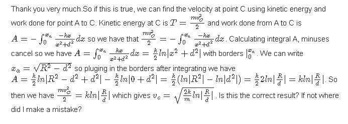

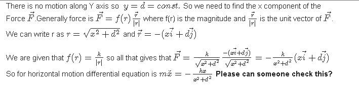

3. The Attempt at a Solution [/B]
Hello guys,I posted images since its easier to write equations.Please can someone help me check this, if this is correct so far, then i should be able to find the velocity at C, using kinetic energy?
Looks good to me.
Chestermiller said:
Looks good to me.
Edit: Work done from A to C is the difference of the potential energy between these two points, am i wrong?

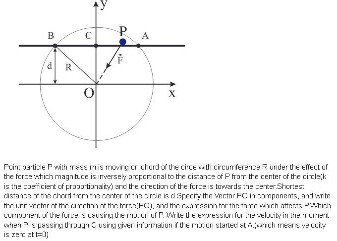

By the way in the problems text i translated R as circumference, but its actually a radius R.
In my judgment, you did all this correctly. I think you should have more confidence in your ability. Your analysis was very nice, perceptive, and mathematically talented.
Chet
Chet
Thank you very much Chet, I can't help it,I always had some difficulties to translate "physics thoughts" into math language so maybe I am overly cautious, sometimes i even waste time writing code for motion simulations to make sure something behaves like its supposed to, but it seems I'm getting the hang of it.Thanks again for your support.
