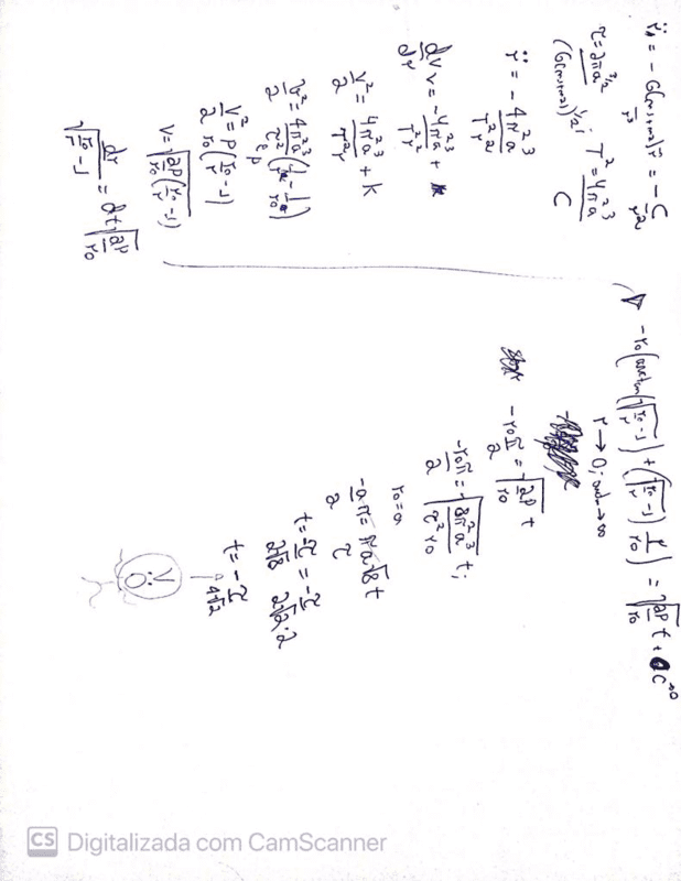

YEs, now i made by the way that i started. Actually i got to t = -τ/4(2)^0.5 maybe I've confused something, i will be looking.
Thank you all
Thank you all
How did you do it? Show your work, please.
ehild said:
How did you so it? Show your work, please.
Here is my solution and me seeing this minus sign after all the work done.
Sorry, I cannot read and do not understand the integral of $$\frac{1}{\sqrt{\frac{r_0}{r}-1}}$$
By the way, your minus sign may come from the the first step when you find v(r) and take it positive, although it is negative with respect to vector r.
The integral ##\int\frac{dr}{\sqrt{\frac{r_0}r-1}}## is not ##\sqrt{\frac{r_0}r-1}##.
I explained how to deal with it in post #5.
Actually i forgot to write the symbol of integral so became confused, and i lost the paper :| So, now i took the value in a calculator, what is the same that i find, except that i found.
:"-ro" and not "-*√ro√ro"
