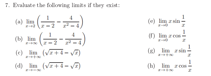

How can I find the limit in question 7e and 7g?
Finding limits is difficult!:cry:
  • Printed problem 7 listing eight limits (a) through (h): several limits of rational and square-root expressions, and (e) lim x sin(1/x) as x to 0, (f) lim x cos(1/x) as x to 0, (g) lim x sin(1/x) as x to infinity, (h) lim x cos(1/x) as x to infinity.

7e: I guess everything is within real calculus. Then you can argue that the sine is bound and thus the limit must be zero:
[tex]0 \leq |x \sin(1/x)| \leq |x| \rightarrow 0.[/tex]
7g: Expanding [itex]\sin(1/x)[/itex] around [itex]x \rightarrow \infty[/itex] gives
[tex]x \sin(1/x)=x [1/x+\mathcal{O}(1/x^3)] \rightarrow 1.[/tex]

How to derive this?
Could you explain more,please?
