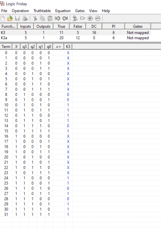

My concern is that, when I tried checking my work, it doesn't match up with what's found on Logic Friday, a program I tried using to minimize the function.
Logic Friday software truth table with 5 inputs X, q3, q2, q1, q0 and output K3, listing terms 0 to 31; K3 is 1 for terms 10, 11, 12, 13, 15, 24, 25, 27, 29, 30, 31 and 0 for 8, 9, 14, 26, 28, with X for don't-care terms.
Text output from a logic minimization tool: a long unminimized sum-of-products expression for K3 entered by truthtable, followed by the minimized form K3 = X q2 q1 + X' q2' q1 + X' q2 q1' + X q2' q1' + q2 q0 + q1 q0'.
