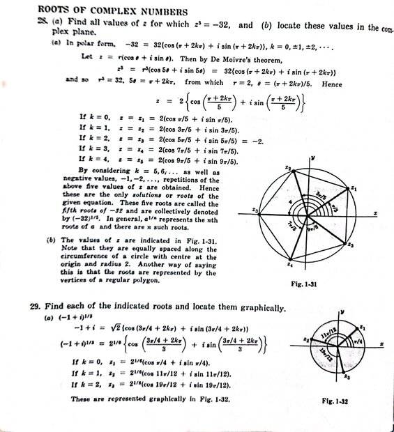

Kindly see attached...I just want to understand why for the case; ##(-1+i)^\frac {1}{3}## they divided by ##3## and not multiply ?
Complex numbers
Kindly see attached...I just want to understand why for the case; ##(-1+i)^\frac {1}{3}## they divided by ##3## when working out the angles...
Am assuming they used;
##(\cos x + i \sin x)^n = \cos nx + i \sin nx## and here, we require ##n## to be positive integers...unless I am not getting it...sorry using phone to type ...I will put this into context later...
For ##z^5 = -32## No issue here...the steps ,that is division by ##5## is clear.

Write cis ##x## as abbreviation for ##(\cos x + i\sin x)##.
Assume we can write ##(-1+i)^{\frac13}## as ##z=r\,\textrm{cis}\,\theta##.
From de Moivre we have
$$-1+i=z^3=(r\,\textrm{cis}\,\theta)^3 = r^3\textrm{cis}\,3\theta$$
So the argument (angle) for ##-1+i## in the complex plane is three times the angle of ##z##. So to get the angle of ##z## we need to divide the angle of ##-1+i## by 3.

Polar form of complex number,
[tex]-1+i= \sqrt{2}\ e^{3/4\ \pi\ i}[/tex], is easy to handle power 1/3. Dividing phase by 3 and multiplying cubic roots of 1,
[tex](-1+i)^{1/3}= \sqrt[6]{2}\ e^{1/4\ \pi i + 2/3\ n\pi i}[/tex]
where n=-1,0,1.

The above is wrong. You have mixed up the representations of z and ##z^3##.
Much simpler:
Let ##z = -1 + i##
Converting to polar form, we have ##z = 2^{1/2} cis(\frac{3\pi}4 + 2k\pi)## where cis(A) means cos(A) + i sin(A).
Then ##z^{1/3} = 2^{1/6} cis(\frac{\pi}4 + k\frac{2\pi}3), k = 0, 1, 2##
Notice that there are 3 cube roots of z. All have modulus (magnitude) ##2^{1/6}##. Their arguments (angles) are ##\pi/4, \pi/4 + 2\pi/3##, and ##\pi/4 + 4\pi/3## respectively.

The difference between what andrewkirk wrote and what I wrote is that we defined z differently. Andrew is defining z as ##(-1 + i)^{1/3}##. I am defining z as -1 + i. It doesn't matter what you start with as long as your work is consistent with how you defined things.
The error in your work in post #5 is here:
Let ##z^3=(-1+i)##
... then, ##(-1+i)^\frac{1}{3}=z##
In polar form,
##z=2^\frac{1}{6}\left[\cos (\dfrac{3π}{4}+2kπ)+ i \sin (\dfrac{3π}{4}+2kπ)\right]^3##
That exponent of 3 at the far right should not be there.
If ##z = r(\cos(\theta) + i\sin(\theta)) = r cis(\theta)##,
then one value of ##z^{1/n}## is ##r^{1/n} cis(\theta/n)##.

My confusion is here;
is it correct therefore to say
##[\cos θ + i \sin θ]^n = cos n θ + i \sin nθ##
and
##[\cos θ + i \sin θ]^\frac{1}{n} = \cos n θ + i \sin nθ##

Yes.
No.
In that order.
chwala said:
Thanks Mark, do we treat/substitute ##n=3## and ##n=\dfrac{1}{3}## the same way? that is specifically on,
##z^n = ...cis\left[ \frac{3\pi/4 + 2k\pi}n\right]##
No. I claim credit for some of your confusion. The above, which is part of something I wrote but have since corrected, should not have the angle divided by 3. The angle should have been multiplied by 3. For the problem in this thread, we have ##z = -1 + i##, so ##|z| = \sqrt 2##, and ##\theta = \frac{3\pi}4##.
Then, ##z^3 = |z|^3cis( 3(\theta))##
and ##z^{1/3} = |z|^{1/3}cis(\frac 1 3(\theta + 2k\pi))##, with |z| and ##\theta## as above.
For positive integral powers, you don't need to include that extra ##k2\pi## term - raising a number to a positive integer power gets you just a single value.
For roots, you do need to include the multiples of ##2\pi## in order to get all of the roots. If you don't include that extra part, you'll get only the principal n-th root.

That was my initial argument in post ##1## when I asked why are we not multiplying...anyway I'll need to go through the entire thread again...cheers man!
Lalalala...I think I now got it! I will post my understanding later... cheers guys!

##z=r^\frac{1}{n}\left[\cos (θ+2kπ)+ i \sin (θ+2kπ)\right]^\frac{1}{n}##
## =r^\frac{1}{n}\left[\dfrac{\cos (θ+2kπ)}{n}+\dfrac{\sin (θ+2kπ)}{n} \right]##​
As already noted for your first case, the above is incorrect. The angle is what gets divided/multiplied, not the cosine or sine of the angle.
chwala said:
@Mark44 like you said it does not really matter whether ##n## is positive or fractional index.​
Probably the only variation would be on say;​
3. ##z^n=x^\frac{n_1}{n_2}## where ##n_1## and ##n_2## are integers then, our solution will be of the form,​
##z=r^\frac{n_1}{n_2}\left[\cos (θ+2kπ)+ i \sin (θ+2kπ)\right]^\frac{n_1}{n_2}##
## =r^\frac{n_1}{n_2}\left[\dfrac{\cos (n_1(θ+2kπ)}{n_2}+\dfrac{\sin n_1(θ+2kπ)}{n_2} \right]##​
I would appreciate your input or comments of correction...cheers.​
You don't need separate cases for #2 and #3.
If z = x + iy, where x and y are real numbers, then
##z^n = r^n [\cos(n(\theta + 2k\pi)) + i \sin(n(\theta + 2k\pi))] = r^n cis(n(\theta + 2k\pi)##
If n is a positive integer, you can omit the ##2k\pi## terms.
If n = 1/m, where m is a positive integer, k will be in the range 0, ..., m-1.
If n is a rational number in reduced form a/b, then ##z^n = z^{a/b} = (z^{1/b})^a##, so the above apply.
The basic idea when a complex number z is written in polar form is this:
##z = r cis(\theta) \Rightarrow z^n = r^n cis(n \theta)##
To raise a complex number to a power, raise the modulus (magnitude) to that power and multiply the argument (angle) by that power -- this is called De Moivre's Formula. See https://en.wikipedia.org/wiki/De_Moivre's_formula.
