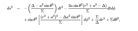

how to find tetrad of this metric
the tetrad given is this one

Your tetrad is just an orthornormal basis of one forms.
In index-free notation, the four one-forms are ##e^0, e^1, e^2, e^3##. Note that here the superscripts are not tensor indices, they are selectors, so that ##e^0## is the first memeber of the set, ##e^1## is the second member of the set, etc. In index-free notation we don't need the subscript.
The components of ##e^0## are written by the author of the paper you reference as ##e^{(0)}_a##, similarly for the other members of the tetread.
Note that dt, ##d\theta##, ##d\phi##, and dr as I write them also one forms. The author of the paper writes the components, so where I write dt he writes ##dt_a##, and similarly for the other one-forms.
The point then is the metric is just
$$-e^0\otimes e^0+ e^1 \otimes e^1 + e^2 \otimes e^2 + e^3 \otimes e^3$$
(I actually only verified the component for dt^2, but I think the others work out as well, but you should double check this).
Deriving this is basically just a matter of factoring the line element with algebra. It may help to re-write the original Kerr metric in the same index free notation that I use. If you go this route, don't forget that the metric must be symmetric, ##dt \otimes d\phi## is not the same as ##d\phi \otimes dt##. So the line element written as (...)dt##d\phi## becomes ##\frac{1}{2}## (...) (dt ##\otimes d\phi + d\phi \otimes## dt)

The problem is that the paper is wrong to say "the" tetrad. You can just pick any four orthonormal vectors and there you have a tetrad. And there are infinitely many ways to do that.
Unfortunately, the paper doesn't appear to say why it made that choice. It merely cites reference 16, which is a Phys Rev D paper that's behind a paywall. If you have access, look at that.
If you don't have access, it's worth noting that a tetrad at event ##t,r,\theta,\phi## is the basis for the natural local Minkowski frame of an observer whose four-velocity is parallel to ##e^{(0)}## - i.e. ##u^ae_a^{(\mu)}## is -1 for ##\mu=0## and zero for all other ##\mu##. So if I were you I'd write down that four velocity and work out what it means. For example, is it undergoing proper acceleration? In what direction?
That is basically the reverse of the process for writing a tetrad field. Usually you would say that you want the tetrads associated with a family of observers with certain properties (e.g., hovering at constant altitude, or freely infalling), which would let you write your timelike tetrad vector. Then you pick an orientation for the spacelike vectors, and then you've got your tetrad.
