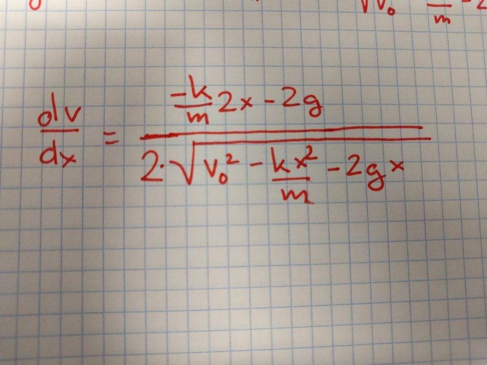

  • #48
So I got this as the derivative. Is this a(x)?
  • #49
spsch said:
\sqrt wasn't enough yet
##\TeX## now stumbles over _^ without anything in between
244680
v_0^2 will fix it. You also don't really want the comma. And don't worry: we do it because we like to do it or else we wouldn't do it :smile:
Given up on ##\LaTeX## ? and back to images... :cry:
Methinks the image in #48 is a good answer to the problem statement in #19 (also an image :frown:).
Whether it's still correct can be checked 'easily':
  • ##{dv\over dx} = 0\ \ ## at ##\ \ x_0 = - {mg\over k} ##
  • substitute ##\omega =\sqrt{k\over m}, \ \ \xi = x_0-x, \ \ v = ## ... oh, well, maybe not that easy ...
and all that for 3 points ...
Makes me curious to see parts b) and c)
  • #50
I should think ##a(x) = -\omega^2 (x-x_0) \ \ ## with ##\ \ \omega^2 = {k\over m}##
In other words: ##{da\over dx} = -\omega^2 ##
  • #51
I think 48 is the derivative of the solution?
we solved a and b almost I think. a asks to set up the differential equation. b asks to solve it.
I haven't looked at what c and d is yet, but it seems not to difficult, c) asks you to graph the function v(x) in an x-v-diagramm.
And d finally asks you for the deviation (*Auslenkung, I don't quite know what that word in german means actually) and the speed of the mass when the spring is pulled 20 cm up or down.
I think it just means plug in 0.2 for x and state the value. so v(0.2).
a, b and c each give you 3 points, d 1 point.
I'll figure out Latex too! :-) It doesn't let me edit the previous post anymore, I think I did it too many times. But next chance I get.

Hi, thank you kuruman. This was very helpful. What gives me trouble is how a(x) has been related to ## \sqrt{ \frac km} ## by just knowing x.
I see how it's the acceleration. I had some trouble following it. It's more clear now, but still a little fuzzy haha. I'm sure it shall clear up.

Does epsilon (if it is epsilon, the additional stretch) just represent dx here?

With all this equation (2) becomes$$ME=\frac{1}{2}mv^2+mg\xi-\frac{1}{2}k\left(\xi- \frac{mg}{k}\right)^2-\left(\frac{mg}{k}\right)^2$$
Did you mean $$ME=\frac{1}{2}mv^2+mg\xi+\frac{1}{2}k\left(\left(\xi- \frac{mg}{k}\right)^2-\left(\frac{mg}{k}\right)^2\right)$$

##\xi##, pronounced "ksy", is the Greek equivalent of x. Not sure how you are defining dx here, but that usually refers to an infinitesimal change. @kuruman is using ##\xi## to stand for a variable like x but differing from it by a constant amount.
