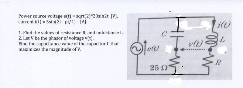

Power source voltage e(t) = sqrt(2)*20sin2t [V],
current i(t) = 5sin(2t - pi/4) [A].
1. Find the values of resistance R, and inductance L.
2. Let V be the phasor of voltage v(t). Find the capacitance value of the capacitor C that maximizes the magnitude of V.

You know R and L so you can come up with the voltage V1 between L and R.
You can also write an expression for the voltage V2 between the 25 ohm resistor and C. This will of course be a function of E and C.
Then maximize (V2 - V1) with respect to C. (The value of C will not be a function of E).
All V are phasors. E is the phasor of e(t).

How do I write an expression for the voltage V2 between the 25 ohm resistor and C? I don't know the current across it.
The current phasor through (not "across") C and the 25 ohm is E/Z where Z = 25 -j/ωC.
