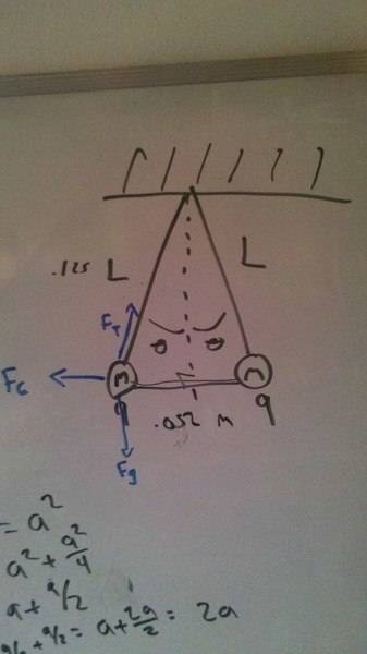

Two identical point charges with a mass <i>m</i> and equal charge <i>q</i> repel each other at the end of a lightweight rope of length L=12.5cm. The angle θ is 17.5 degrees.
a)What is the mass <i>m</i>?
b)What is the charge <i>q</i>?
Fx= Fe-Tcosθ=0
Fy=mg-Tsinθ=0
Fe=kq1q2/r^2
I have a free body diagram drawn up(don't know how to post them sorry) of the left ball, with the Fg acting downwards, the Ft acting towards the connecting point with the ceiling and the Fe pointing horizontally away from the opposite sphere.
The problem I'm having is I don't know how to find the mass since it seems no matter how I try to go about solving this equation I always have two unknowns.
I cannot tell if I'm just missing something simple by looking too hard at it, but I can't seem to figure out where to start. Any suggestions?

The charge and the mass cannot be found independently. All you can do is find the ratio [itex]q^2/m[/itex].

Darth, This equation given by the OP is not correct. It's not clear which force F stands for here. But whether F stands for the electric force or the tension in the string, it is still not correct.
In the original post, the OP essentially stated the correct relevant equations if θ is measured from the horizontal. However, I suspect that the angle that was given in the problem is measured from the vertical. If so, sinθ and cosθ should be switched in the equations.

I assume your question says " there are two branches of the rope each containing the unknown charge with unknown mass at their ends ".From the free body diagram I get from this interpretation there are three concurrent forces on each charge namely the tension of the string(T),The weight (W) and electrostatic force of repulsion(F).The angles between them are clearly obtainable (using the inclination of one string as given).If you use lami's theorem for equilibrium in case of concurrent forces it is evident that you can at best obtain the ratio of the square of the charge to the mass.This is based on my interpretation though.You need to post a picture of your case.

I've included a diagram of what the problem looks like. It's too late for me to fix my answer but I still want to know how to solve such a problem for the sake of knowledge.
