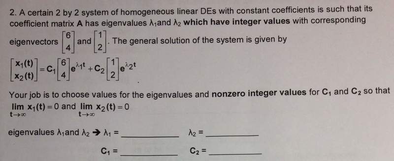

I really don't know where to start. There is nothing given for me to start with. And the instruction says "Choose" so am I really suppose to really choose or do you guys any idea how to start this?
*I know that eigenvalues have to negative

I suspect that the reason for the word "choose" is that there are an infinite number of solutions. For example, a "trivial" solution is C_1= C_2= 0 and \lambda_1 and \lambda_2 can be anything. If C_1 and C_2 are not both 0, then it is a little more interesting. What can you say about the limit of e^{\lambda t} as t goes to 0? Look at \lambda> 0 and \lambda< 0.
all i can say is that lambda has to be negative for it to go 0 right?
Yes.
so i can pick any negative integer number for lambda and any integer for C1 and C2?
