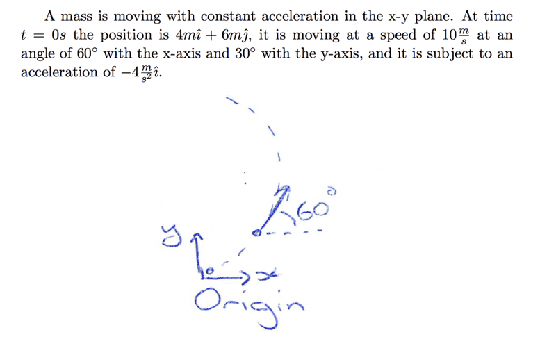

At what time in the future will the x-component of the masses position be at 0m?
x=x,initial+(integral0,t)(v,xcomponent)(dt)
The solution is 3.1 seconds... not really sure where to start :(
In order to carry out the calculation indicated in your equation above, you need to know the x-component of v at time t---which you can (and should) write as v_x(t), or vx(t), using the "x2"" button on the gray palette at the top of the input panel. You are given an expression for acceleration, and you are given enough information to work out the initial vx(0) and vy(0) values, so you can work out vx(t) and vy(t). After that you can just go ahead and carry out the work in your equation.
Thank you! i know how to get the initial x and y components at t=0. What equations should I be using to get the position 0 at the unknown time
Well, YOU were the one that wrote down the necessary equation.
Yeah! I am unsure of how to use it.
As Ray indicated in post #2 you first need another integral equation, one relating velocity to acceleration.
