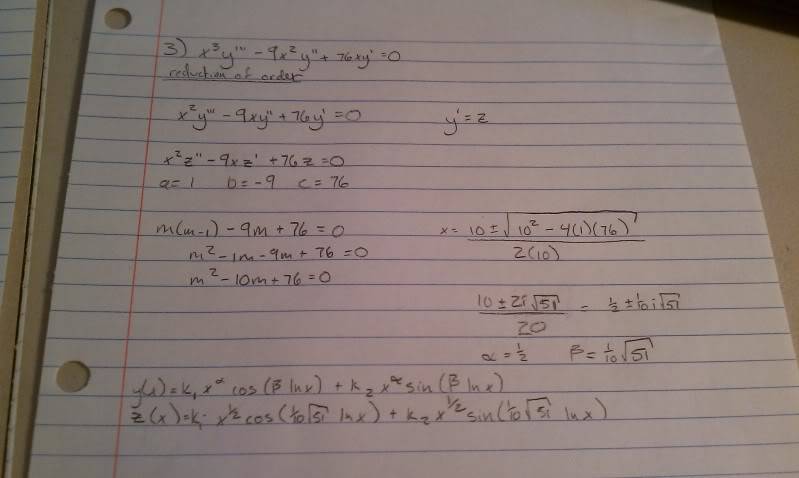

It might be simpler to let y' = z and divide both sides by x (for x =/= 0), to get:
x^2 z'' - 9x z' + 76 z = 0.
RGV

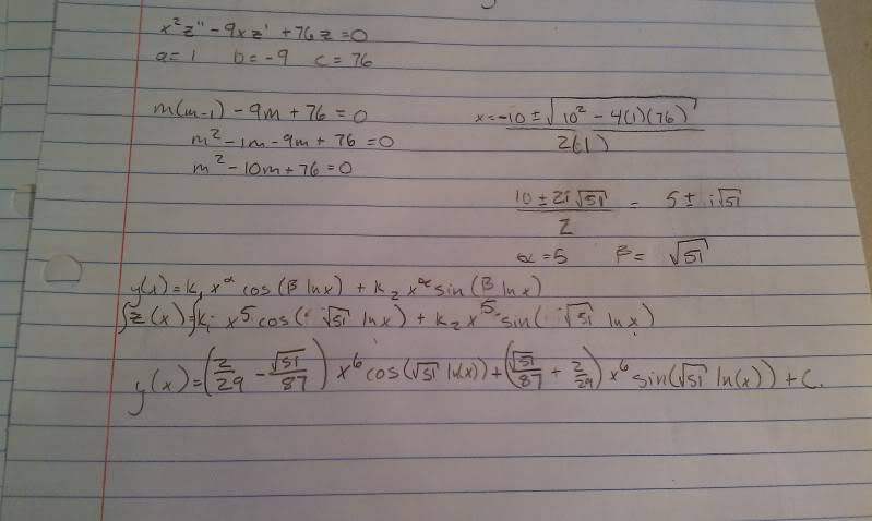

Am I on the right track?
Also, do I just derive the final function since I substituted y'=z?
You made a mistake applying the quadratic equation.
To find y, you integrate the function you get for z(x). You may find you would have been better off finding y(x) directly.
Well, I took the advice as it looked easier, but I see what you mean. Integrating this is stupid, thank god for TI-89.
I'm getting a terribly ugly answer though, but I think it's correct.
How's this look? I fixed the quadratic I think.
You dropped the arbitrary constants when you integrated. You still need them in your final answer, and you can absorb those numerical constants on each term into them. Other than that, it looks good.
You should try substituting the solution back into the original DE to make sure it works.
Oh, I forgot to put them back in once I got the integral off of my calculator.
Will do though, thanks for the help! Differential equations will be the death of me, I'm tired of getting terrible grades.
