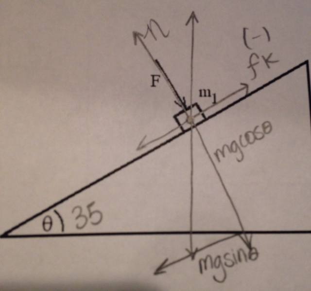

The coefficient of static friction between the crate m1=3.00kg and the incline with θ=35° shown in the figure below is .300. What minimum force F must be applied to the crate perpendicular to the incline to prevent the crate from sliding down the incline?
mgsinθ
μsmgcosθ
f=ma
I don't quite get how the applied force fits into the equation. mgsinθ-μsmgcosθ+F=0?
  • Free-body diagram of a block m1 on an incline at θ = 35°, with force F pressing perpendicular into the surface, normal force N, kinetic friction fk pointing up the slope, and weight components mgcosθ and mgsinθ.
Your equation is almost right. You are not interested so much in F itself but the additional frictional force caused by F.
