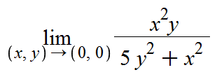

I take this opportunity to make a basic question.
there is some method to determine if the limit exists?, and not try all possible ways to reach the indeterminate point.
example:
the limit is 0 but the method is try the path of x=0, y=0, y=mx , y=mx^2+nx.
there any way to know if the limit exists or not exist that does not involve check all the paths like a computer ?

My first thought when I saw this limit was moving to polar coordinates, because it has terms that look like ##x^2+y^2##. So I just added in the denominator ##+4x^2-4x^2(=0)## to get something with the ##5y^2##. Then I arrived to ##r\cdot ##(some finite number) which goes to 0 as ##r## goes to 0.

There is an infinite set of paths, you cannot check them all.
Going to radial coordinates is often a good approach.
radical coordinates is good, ok.
thanks =D
