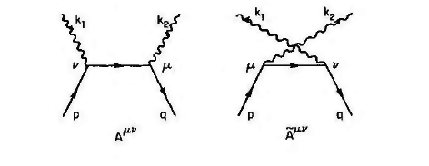

In the process $$e^+e^- \rightarrow \gamma \gamma$$
for which the amplitude can be written as: $$M= \epsilon^*_{1\nu}\epsilon^*_{2\mu}(A^{\mu\nu}+\tilde{A}^{\mu\nu})$$, where $$\epsilon_i$$ is the polarization vector of a photon.
How can one find the tensors $$A^{\mu\nu}$$ and $$\tilde{A}^{\mu\nu}$$?
Are you familiar with Feynman rules?
Hey @Orodruin I am to a certain extent but I can't figure out what are the tensors here if you may help?
They are simply the amplitudes you would get by applying the Feynman rules to the corresponding diagram.
But I already posted the amplitude $M$ in the question above. I do not think you are saying that $M$ equals to tensors $A's$, right? If so, may you please elaborate?
M is an invariant. The amplitudes A are given by applying the Feynman rules to the diagrams and factoring out the photon polarizations.

Aha, I searched and found it to be for the first let's say $$(ie)(-ie) \bar{\nu}(q) \gamma^{\rho} \epsilon_{\rho} \frac{i}{\gamma^{\rho} p_{\rho} - \gamma^{\rho}k_{1\rho} - m} \gamma^{\rho}\epsilon_{\rho} u(p)$$ If this is correct, how come this is a tensor with both indices as indicated above?
I am afraid A^{\mu\nu} represent photon propagators and not amplitude. @Orodruin
Your expression in #10 looks on the way to becoming fine. You have not factorised out the ##\epsilon##s and you are using the same name for several different summation indices.

If you do both of the diagrams, and factor out the polarizations, and add the diagrams together, you should be able to get it into a form matching your original equation. The A's in your case are just generic tensors that you have to solve for, and the way you solve them is by doing the diagram.Also, there are no photon propagators in those diagrams.

That's easy to see if you understand that they are telling you that you use the Feynman rules to write [itex]M[/itex], and then from that expression you get, you factor out the epsilons and get the form of [itex]M[/itex] you have posted and the [itex]A[/itex]'s.
This is your problem. Remember to have control over your own indices, and NEVERrepeat their use. I can rewrite this as :
$$(ie)(-ie) \bar{\nu}(q) \gamma^{\mu} \epsilon_{2 \mu} \frac{i}{\gamma^{\rho} p_{\rho} - \gamma^{\rho}k_{1\rho} - m} \gamma^{\nu}\epsilon_{1 \nu} u(p)$$
because the choice in labeling your indices when converting from a dot product or slashed-object to explicitly writing out the gamma matrices is arbitrary, but must never be repetitive.
Also, in the written diagrams it has the "1" photon associated with the ##\nu## vertex. So when you write out the diagram, it tells you how to write it.
As for the complex conjuagates on the polarizations, this is to designate whether the photon is incoming our outgoing. It will have come from which state (initial or final) the A operator acted on.

Great, it helps yes. So you meant to write $$\epsilon_{1\nu}$$ instead of $$\epsilon_{2\nu}$$ at the end of your amplitude if I am not mistaken. Thank you, you have been a great help!
Yes sorry. Ill change it now.
