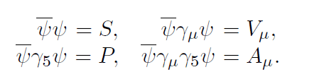

All I know is the set of rules regarding scalar ##S## , pseudoscalar ##P##, vector ##V_{\mu}## and axial vector ##A_{\mu}## fields i.e.
Four bilinear forms in Dirac spinor notation: psi-bar psi = S, psi-bar gamma5 psi = P, psi-bar gamma_mu psi = V_mu, psi-bar gamma_mu gamma5 psi = A_mu.
In this case you have a pseudo-tensor fully contracted with indices from tensors. The result of this is a pseudo-scalar, which therefore picks up a - sign under parity transformations.

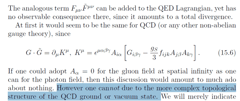

Here's the section of the book I am talking about
Printed textbook page on QCD Lagrangian: text introduces term from field strength tensor G-dot-G-tilde, then Eq. (15.1) giving L_eff = L_QCD + (theta g_s^2 / 32 pi^2) G-dot-G-tilde, followed by a sentence on parity and time reversal violation.
Text page with two equations: G·G proportional to sum of |E_a|^2 plus sum of |B_a|^2, mapped under P,T to the same expression; G·G-dual proportional to sum of E_a·B_a, mapped under P,T to its negative; followed by transformation rules for E_a and B_a under P and T.

OK so now I understand that the term ##G\cdot \tilde G## breaks CP in QCD. However, the analogous term in QED ( that is ##F\cdot \tilde F##) does not break CP in QED. To understand why, I will read more about it and then post (it seems that it has to do with the fact that the structure of the QCD ground state is more intricate ...).
Actually, I'm pretty sure that ##\tilde{F}F## also breaks CP, since both gluons and photons transform the same way under such a transformation. To prove that such a term in the QED Lagrangian is not physically relevant, while in the QCD Lagrangian it affects the physics is a different story...
Anyway, I have no idea how you are supposed to use the ground state here...
I see. They actually state that ##F \cdot \tilde{F}## term can be dropped as it "amounts to a total divergence".
Printed textbook page: text stating that F_{mu nu} tilde F^{mu nu} adds to the QED Lagrangian with no observable consequence, and equation 15.6 writing G dot tilde G as the divergence of K^mu. The last sentence is highlighted.
I am trying to figure out how to prove that statement before tackling the QCD ground state argument.

Alright, I am trying to prove EQ. (15.6) in a purely mathematical way.
Let us recall that repeated pair of indices are summed over and
\begin{equation*}
G_i^{\mu \nu} := F_i^{\mu \nu} + g_s f_{ijk} A_j^{\mu} A_k^{\nu}, \quad F_i^{\mu \nu} := \partial^{\nu} A^{\mu}_i - \partial^{\mu} A^{\nu}_i, \quad G \cdot \tilde G := \varepsilon_{\mu \nu \rho \sigma} G_i^{\mu \nu}G_i^{\rho \sigma}
\end{equation*}We are allowed to write ##G \cdot \tilde{G} = \partial_\mu K^\mu## because, given the definitions of ##G## and ##\tilde{G}##, it happens to be true that there exists an object ##K^\mu## such that the equality holds. So in order to prove it, we work out ##G \cdot \tilde{G}## explicitly
\begin{align*}
G \cdot \tilde G &= \varepsilon_{\mu \nu \rho \sigma} G_i^{\mu \nu}G_i^{\rho \sigma}\\
&=\varepsilon_{\mu \nu \rho \sigma} (F_i^{\mu \nu} + g_s f_{ijk} A_j^{\mu} A_k^{\nu})(F_i^{\rho \sigma} + g_s f_{ilm} A_l^{\rho} A_m^{\sigma})\\
&=\varepsilon_{\mu \nu \rho \sigma} (F_i^{\mu \nu}F_i^{\rho \sigma} + g_s f_{ilm}F_i^{\mu \nu}A_l^{\rho} A_m^{\sigma} + g_s f_{ijk} A_j^{\mu} A_k^{\nu} F_i^{\rho \sigma} + g^2_sf_{ijk}f_{ilm}A_j^{\mu} A_k^{\nu}A_l^{\rho} A_m^{\sigma})\\
&= \partial_{\mu}(\varepsilon^{\mu \nu \rho \sigma} A_{\nu}^i [G_{\rho \sigma}^i - \frac{g_s}{3}f_{ijk} A_{j\rho} A_{k\sigma}])
\end{align*}
In order to get to the final result I guess that we will have to make use of the fact that the LC tensor is totally antisymmetric and pull out a derivative ##\partial_{\mu}## but I do not see how...
Any help is appreciated :biggrin:
Yes, indeed you must use all the symmetries of your tensors. I would suggest you to start by showing that
$$\varepsilon_{\mu\nu\rho\sigma}F_i^{\mu\nu}F^{\rho\sigma}_i = \partial_\mu\left(\varepsilon^{\mu\nu\rho\sigma}A_\nu^i F_{\rho\sigma}^i\right)$$
  • Love
Mmm I did not quite get it yet.
\begin{align*}
\varepsilon_{\mu\nu\rho\sigma}F_i^{\mu\nu}F^{\rho\sigma}_i &= \varepsilon^{\mu\nu\rho\sigma}F^i_{\mu\nu}F_{\rho\sigma}^i \\
&= \varepsilon^{\mu\nu\rho\sigma}(\partial_{\nu} A_{\mu}^i - \partial_{\mu} A_{\nu}^i)F_{\rho\sigma}^i \\
&= -\varepsilon^{\mu\nu\rho\sigma}\partial_{\mu} A_{\nu}^i F_{\rho\sigma}^i
\end{align*}
Where the first term drops because ##\varepsilon^{\mu\nu\rho\sigma}## is antisymmetric under ##\mu \leftrightarrow \nu## while ##\partial_{\mu} A_{\nu}## is symmetric (not completely sure if this is OK). Next I thought of product rule + divergence theorem
\begin{equation*}
\underbrace{\partial_\mu\left(\varepsilon^{\mu\nu\rho\sigma}A_\nu^i F_{\rho\sigma}^i\right)}_{=0?} =\underbrace{\partial_\mu(\varepsilon^{\mu\nu\rho\sigma})A_\nu^i F_{\rho\sigma}^i}_{=0} + \varepsilon^{\mu\nu\rho\sigma}\partial_\mu A_\nu^i F_{\rho\sigma}^i + \varepsilon^{\mu\nu\rho\sigma}A_\nu^i \partial_\mu F_{\rho\sigma}^i
\end{equation*}
So ##-\varepsilon^{\mu\nu\rho\sigma}\partial_{\mu} A_{\nu}^i F_{\rho\sigma}^i = \varepsilon^{\mu\nu\rho\sigma}A_\nu^i \partial_\mu F_{\rho\sigma}^i## but I do not see how this is going to be helpful...
