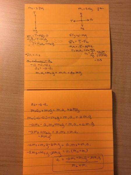

  • #58
So does this solution make sense to you?
  • #59
haruspex said:
a1+a2= -a.
I again tried solving that solution with the system of equations:
a1+a2= -a and a2 = 2a1
and I got a1 = (-1/3)a which is still incorrect despite every step seeming to be correct.
Also do we need to use the numerical value for m1 at all?
  • #60
hmm.. that is the answer I get.
No. Only the ratio of the masses can be relevant.
