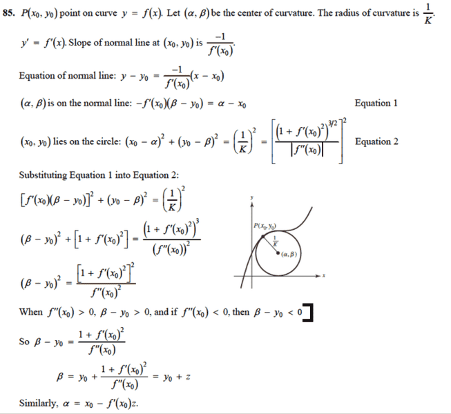

Let C be a curve given by y = f(x). Let K be the curvature (K \ne 0) and let z = \frac{1+ f&#039;(x_0)^2}{f&#039;&#039;(x_0)}. Show that the coordinates ( \alpha , \beta ) of the center of curvature at P are ( \alpha , \beta ) = (x_0 -f&#039;(x_0)z , y_0 + z)
I attached a picture of the solution. The portion of the solution with a half-box I would appreciate someone helping me with.

With respect to your question in this thread, if f'' > 0 the curve is concave up, so the circle is above the curve. At the point shown, f'' < 0 so the curve is concave down and the circle is below the curve. That determines whether ##\beta## is less or greater than ##y_0##.
Ooh, you are very right. Thank you much for your help.
