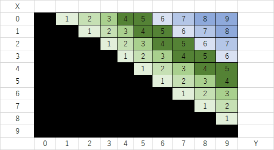

I also made a table with number Z in the cells.
Grid with rows labelled X from 0 to 9 and columns labelled Y from 0 to 9, filled with green-shaded cells holding integers 1 to 9 in an upper-right triangle, with the rest blacked out.

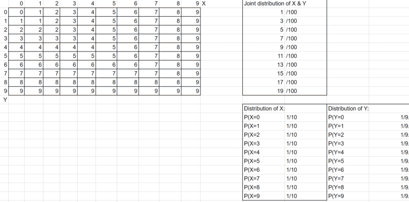

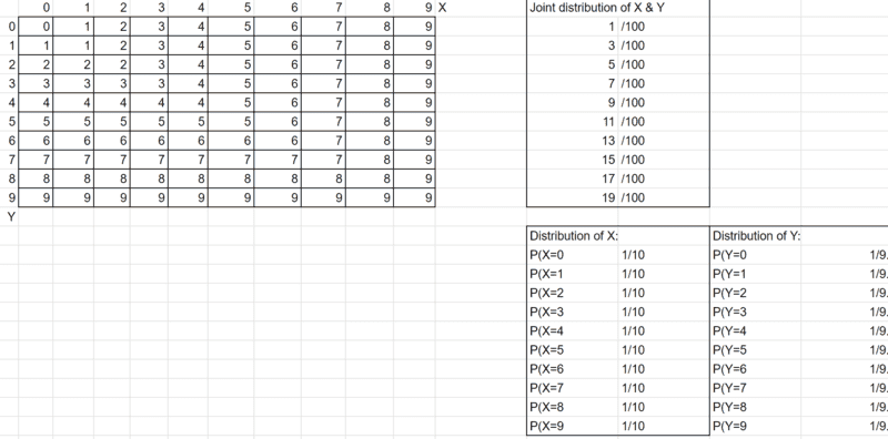

Spreadsheet with a 10 by 10 table of values max(X,Y) for X and Y from 0 to 9, a joint distribution table of values 1/100 to 19/100, and distribution tables listing P(X=0) to P(X=9) as 1/10 and P(Y=0) to P(Y=9) as 1/9.
I tried to correct the mistakes by making a 10x10 table.
We have the same chance of getting a number from 0 to 9, so the distribution of (X=x) should be 1/10.
Since we have already picked a number for X, (Y=y) should be 1/(10-1) = 1/9?

You pick up two tickets AT A TIME. Then you read them to call larger one Y and smaller one X.
All the possible cells in the table have an equal probability.

Oh so X=x and Y=y have an equal distribution. I will correct it. Thank you.

I would say all the cells (x,y) x<y are equal in probability or in distribution.

Your distribution of Y adds up to more than 1, so we can see it must be wrong. Furthermore, it does not make sense that the probabilities of the X values are equal. Can the maximum being 1 (only two ways to get that) really be as likely as the maximum being 9 (more than two ways to get that)?

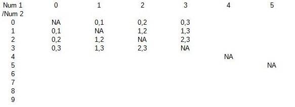

I would start with a 10x10 table of the two numbers drawn. In each cell, I would put the Y,X values and see the pattern. Each combination of two numbers has equal probability, so we can just count how many of the cells are in particular events like X=3 or Y=5. I think you had the right pattern in the top section of your original post, but it is hard to read and unexplained.
Table with rows and columns labeled 0 to 9 showing pairs Num 1 and Num 2; cells list pairs such as 0,1, 0,2 and 1,2 and are marked NA on the diagonal, with entries only in the upper-left block.
