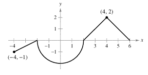

Define the function over the four intervals in order to find the area under the curve from [-4,6].
To do so, find the equations of the line and circle, using the data in the graph.

To be honest, there is no attempt at a solution except staring at it for 4 hours. Given a function, I can integrate. But findind the equation based on the graph confuses me. It has been years since I last did such a thing.
There are basically 4 shapes defined by semicircles and line segments. Boundaries are at [-4,-1], [-2,0], [2,0], [4,2], [6,0]. The lines should be easy to figure out, and the equation for a circle centered at the origin of radius a is [tex]\pm\sqrt{a^{2}-x^{2}}[/tex]
rather than trying to find a function for the lines, why not just break them up into simple geometrical shapes and find the areas under the curve?
For example:
the area of a circle is pi(r)^2
and the area of a triangle is 1/2(bh)
There are four functions you need to find from this graph: 3 linear functions and one that represents the lower half of a circle. Going left to right, the first function is defined on the interval [-4, -2]. The function that represents the lower half of the circle is defined on the interval [-2, 2]. The other two functions are defined on the intervals [2, 4] and [4, 6].
If you are given two points on a line, can you find the equation of the line?
If you know the radius of a circle and its center, can you find the equation of the circle?

The area under this curve is infinite. Doesn't the problem actually ask you to find the area between the curve and the x-axis?
Also, dancergirlie's tip is a good one, and gives the easiest way to find this area, unless you actually have to come up with the functions.
