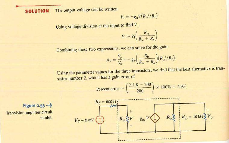

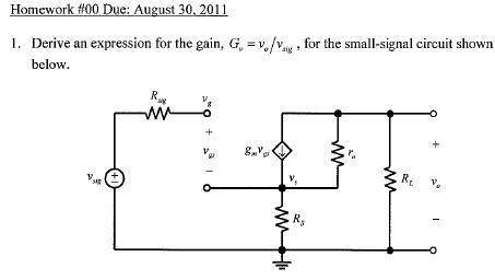

As previously stated in other threads, I have started to work on a summer assignment for my Fall semester EE course. I was given a circuit and asked to derive an expression for the gain (Attachment 1). I have not yet started to write out the problem on paper, but have two thoughts as to where I need to begin based on referencing an EE book I've had from previous courses (Attachment 2). Right now all I'm asking for is some input on whether my thoughts are correct about where I should begin, or I'm just making things up. Any input would be much appreciated!
(Attachment 1)
Derive an expression for the gain of the small-signal circuit shown.
Ok so with looking at the book, it seems to be I need to begin on the right hand side of the circuit for this problem. Now my two thoughts are:
  1. ro and Rs are in parallel/series, which the result is then in parallel with RL
  2. ro and RL are in parallel
My mind is 95% with my first thought, but the second thought is something that's making me second guess myself.. Any thoughts?

Consider replacing the dependent current source and ro with their Thevenin equivalent. Then you should be able to write a loop equation and incorporate the appropriate dependencies. With the loop current you can then determine the output voltage across the load resistor.

Quick question, I asked one of my classmates as to how he went about solving this problem (I've never been the best with Thevenin), and he did it this way:
  1. He first came up with a KCL expression for the current (Equation 1 below)
  2. Then, solved for Vgs (Equation 2 below)
  3. Came up with a KCL expression at the ground (Equation 3 below)
  4. Plugged equation 2 into 1, getting rid of Vgs
  5. Plugged that into equation 3 and solve for Vo/Vsig
Equation 1: [itex]\frac{V_o}{R_L}[/itex] = gmvgs + [itex]\frac{(Vo-Vs)}{R_o}[/itex]
Equation 2: vgs = vg - vs = vsig - vs
Equation 3: [itex]\frac{v_s}{r_s}[/itex] = -[itex]\frac{v_o}{R_L}[/itex]
Any thoughts to as if this route is correct?
Sure, you can use KCL to analyze the circuit. Equation 3 looks suspicious though. It's got a voltage over a resistance ( = current) set equal to a voltage over another voltage (no units).

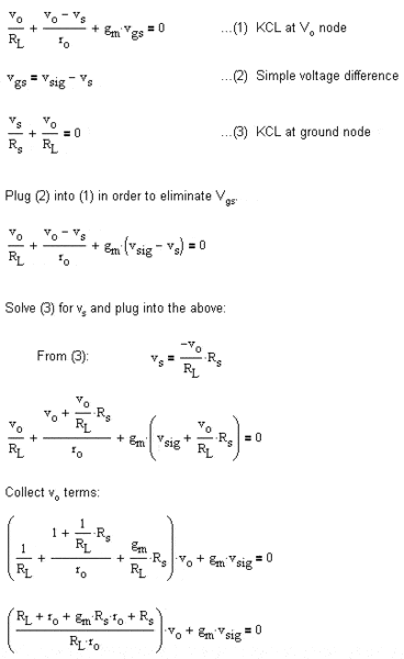

It might more obvious what you need to do if you leave all the terms in the KCL equation on the same side until later in the process; it'll make it easier to collect terms (vo and vsig terms). Here's what I get from your PDF derivations, with the alterations I've mentioned. It just remains to 'finish off' the algebra:

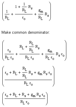

Ok I completely understand where you're coming from now, thanks for the visual :smile: But one thing I have a question on, your last step: Do you not need to have ...+RsRL rather than just Rs? (Within the parenthases)
I don't believe so...
