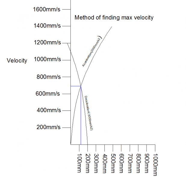

I am trying to calculate the maximum velocity(x) an object reaches between two point. The object accelerates from point A to a certain velocity(x) and then decelerates to point B. The acceleration and deceleration are known but are different. The distance from point A to point B is known. Is there a formula I can use to calculate the maximum velocity between the two points?
I have attempted to solve this by graphing the distance and time of the object and I have attempted rearranging formulas to do this but with no luck.

So an object starts from rest. It accelerates at 2000mm/s2 then decelerates at 3000mm/s2 to rest. The distance from start to finish let's say 200mm. But is it possible to calculate the max velocity reached while traveling between the points?

Thanks for your help. I found a solution. I used the following formulas -> (time = √2Xdistance / accel) and the formula -> (velocity final = time x accel x velocity initial)
I then graphed the velocity for both acceleration and deceleration vs the distance traveled for a number of points. Where the two curves on the graphs met gave me the
max velocity reached between the two points.

Sorry I meant... velocity final = (time x accel) + velocity initial... (typing error!). CWatters I also came out with 0.7m/s. I graphed the max velocity for both acceleration and deceleration against different distances in increments of 100mm for 1m. I was able to read from this the max velocity reached between the points. I have included a picture of my graph for you to see.
Mark
I did it by solving the three equations I posted earlier. Only takes a few steps. That gives the equation...
V2 = 2*D*a*d/(a+d)

Hi CWatters, Thanks for your help this is a much better way of doing it :-)
yeah. suvat is a lot faster here. I would have solved the equations without suvat, but it just depends which way you prefer to do it. (I have long forgotten suvat, so I prefer not to use it).
p.s. nice graph. graphs are always good :)
