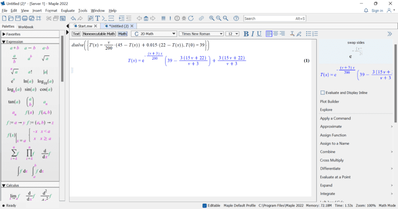

diff(T(x), x) = v/200*(45 - T(x)) + 0.015*(22 - T(x)) where T(0)=39
The following IVP
Describes the tempetatur T in celsius at the time x of a tub filled with water. A tub which is filled with hot water at rate of v l/min.
Lets say I am told that a guy takes a 40 min bath, and during those 40 min he doesn't want the water in the tub to become colder than 37 c.
How would I go about calculating the maximum size of v for that periode?

Sure, If I do a dsolve in Maple on the IVP I get the following solution seen in the screenshot. But how should I got about finding the maximum size of v? If T(40)=37? Thats what I am unsure on.
