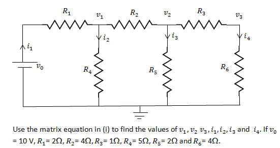

I need to get 7 equations to make a 7x7 matrix in order to solve it. I have 4 of them, but I'm not sure how to get the voltages equations.
I have got four equations so far. One is simply using KCL, I1 = I2 + I3 + I4. The other three are from using KVL and Ohm's Law to get:
1. V0 - VR1 - VR4 = 0
2. VR4 - VR2 - VR5 = 0
3.VR5 - VR3 - VR6 = 0
Applying Ohm's Law:
1. V0 - R1i1 - R4i2 = 0
2. R4i2 - R2(i3 + i4) - R5i3 = 0
3. R5i3 - R3i4 - R6i4 = 0
How do I get 3 equations for the unknown voltages?

I apologise for the incomplete question, I admit I was in a rush typing it out. Here is the relevant question:
You are given V0, and the values of six resistors. The seven unknowns can be treated as elements of a 7x1 matrix. Using Kirchoff's Law and Ohm's Law, write the solution to the resistor network as a matrix equation containing a 7x7 matrix.
Essentially, I will have A*X = B where I'm solving for X.
Oh my, if I simply rewrite each resistor as equations in the 7 unknowns, for example, for R1: R1I1 = V0 - V1, then make V0 the subject, will that be fine? And for the 7th equation, I use I1 = I2 + I3 + I4?

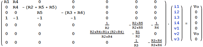

I added the equation suggested by gneill as equation 4 and get this as the 7x7 system you're trying to solve:
Matrix equation: a 7x7 coefficient matrix of resistor terms (R1, R2, R4, R5, R6 and combinations) times column vector i1 to i4, v1 to v3, equals column vector Vo, 0, 0, 0, 0, Vo, 0.
Is this the matrix you solved? What was the result?

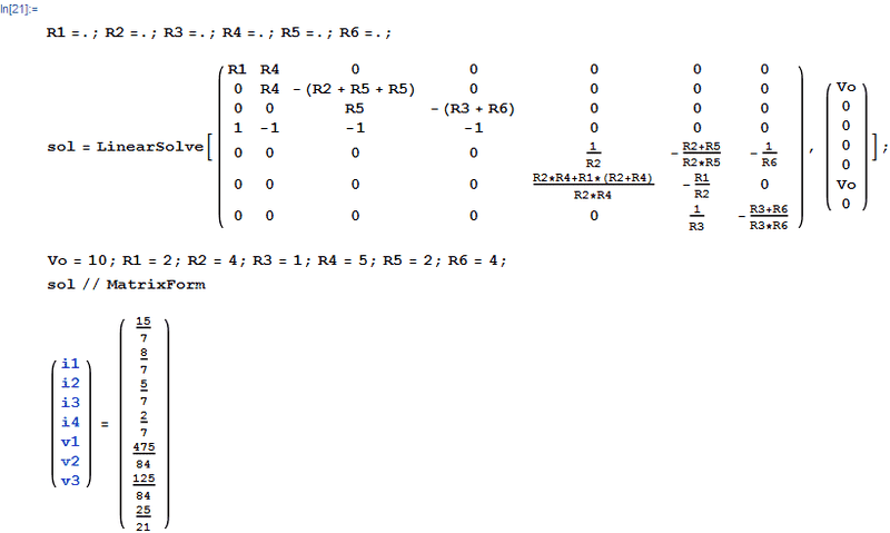

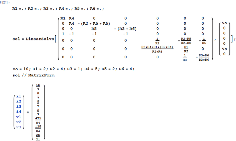

I get this, and the currents are not correct:
Mathematica notebook showing symbolic LinearSolve of a 6x7 resistor-network matrix system with unknowns R1 to R6, Vo = 10 and numeric values substituted, and the resulting solution vector for i1 to i4 and v1 to v3 as fractions.
you made an error in your A matrix. eqn 2
It's not my matrix, it's the OP's matrix, and I was trying to get him to find his error.
oops. I was comparing OPs eqns from post 1 to the matrix, it seems he changed them in post 14
