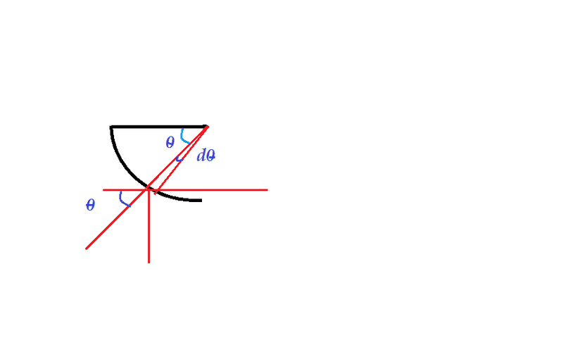

Consider a fixed wedge, whose part is a quarter circle of radius as shown. A small block of mass 'm' slides down the wedge and leaves horizontally from a height 'h' as shown.The coefficient of friction between wedge and block is 'μ[itex]_{k}[/itex]' . Compute the value of in centimetres , where 'x' is the distance from bottom of wedge of the point where the block falls given the values below:
Here is the figure.

I think we have to apply law of conservation of energy here.
i.e., potential energy of block
(E[itex]_{p}[/itex]) =work done by friction (W[itex]_{f}[/itex]) + Kinetic energy (E[itex]_{k}[/itex])...(1)
Here, I have problem in finding the W[itex]_{f}[/itex].
In know F[itex]_{f}[/itex] = μR.
Here, the normal reactionary force which is being exerted on the block on the wedge is not constant. I tried few ways but I am unable to find W[itex]_{f}[/itex]. It would be nice if somebody could help.
And it depends on the velocity. If the acceleration depends on the velocity, a good idea is to set up a differential equation and try to solve that.

I tried this--
dw=μrdθ(mgsinθ+mrω[itex]^{2}[/itex])
I know that ω=dθ/dt.
But putting this does not help.
Is there any other way through which we can find ω?
This is the figure.
What is w?
Can you express everything in terms of θ, ω and dω/dt?

I think I can.
As a=αr and α=dω/dt
gcosθ-gsinθ-rω^2=rdω/dt
Is it right?
Work is not relevant here.
Somehow the μ got lost, apart from that it looks good.

gcosθ-μgsinθ-μrω^2=rdω/dt.
What to do next?

Try the trick of using the chain rule to write dω/dt = (dω/dθ)(dθ/dt)

If you like work and energy, you can get an equivalent differential equation by considering the differential form of the work-energy theorem: dW = d(mv2/2) and using your expressions for the work done by friction and gravity for an infinitesimal displacement ds = Rdθ. This way, you avoid getting a differential equation with a time derivative. (In Satvik's equation, you have a time derivative which can be rewritten in terms of a derivative with respect to θ using the chain rule.)
θ is the independent variable of the diff. eq.
For the dependent variable, y say, choose either y = v2 or y = ω2.

Yes, so the equation becomes $$\omega r \frac{\text{d}\omega}{\text{d}\theta} + \mu r \omega^2 = g \cos \theta - \mu g \sin \theta$$ So, I could solve this for ##\dot{\theta}(\theta)## and input into my W-E energy equation.
Yes. But, of course, if you can solve the differential equation ##\omega r \frac{\text{d}\omega}{\text{d}\theta} + \mu r \omega^2 = g \cos \theta - \mu g \sin \theta## for ##\omega(\theta)##, you essentially have the answer for the speed at the bottom of the track. There is no need to go back to the W-E equation.

Replace the upper limits of integration by an arbitrary angle θ. Then take the derivative with respect to this angle θ using the second fundamental theorem of calculus
If you let y = v2, then you get a linear, first-order differential equation in y that can be solved using an integrating factor.

Notice that
##ω\frac{\text{d}\omega}{\text{d}\theta} =0.5 \frac{\text{d}(\omega^2)}{\text{d}\theta}##
As it was suggested by TSny use ω2=y.
Then you have a first order linear differential equation for y.
$$0.5 r\frac{\text{d}y}{\text{d}\theta} + \mu r y= g \cos \theta - \mu g \sin \theta$$
Solve for y, using the initial condition y=0 at θ=0.
If you are unfamiliar with differential equations yet, try the solution in the form $$y=Ce^{kθ}+A\cos(θ)+B\sin(θ)$$
Find the constants k, A, B which make the equation valid for any θ. Then Fit C to the initial condition.

I have not studied differential equations yet but I have made an attempt to solve it.
AS
I think it is a linear differential equation.
Here integrating factor is
e[itex]^{\intμ/0.5 dθ}[/itex] = e[itex]^{θ}[/itex] (As μ=0.5)
ye[itex]^{θ}[/itex]=[itex]\int e^{θ}.\frac{gcosθ-μgsinθ}{0.5r}[/itex] + C
I can integrate RHS with the help of integration by parts but I am not sure if I am right till here.
Is it right till here,ehild?:confused:

I looks OK, (but substitute μ=0.5 in front of the sin term, too) but you can choose the other method for the solution of a linear differential equation. The solution is equal to Y=Yh+ Yp where Yh is the general solution of the homogeneous part 0.5ry'+μry=0 and Yp is a particular solution of the original equation. In case the right hand side is a sum of sins and cosines, you can try a particular solution also as a linear combination of sins and cosines. It is a bit more elementary than the other method, involving integrals.
