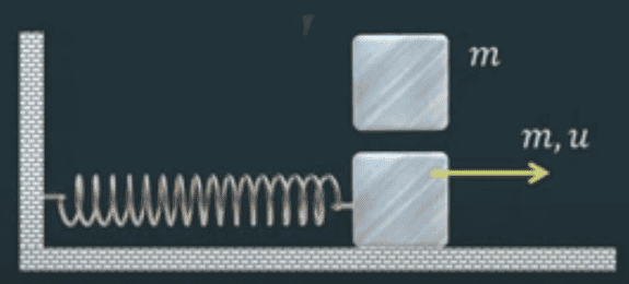

A block is performing SHM with an amplitude ##A## and angular frequency ##\omega##, if an identical block is dropped on the original block while it passes through its mean position find the common velocity of the two blocks, assume friction to be sufficient.
at the mean position of the original block, its velocity is ##V = \omega A##
once the new block is dropped we can conserve momentum in the horizontal direction $$m\omega A = (2m)v$$ $$v = \frac{\omega A}{2}$$
where ##v## is the common velocity of the blocks.
but if instead of conserving linear momentum I try to conserve energy to find the common velocity
$$ (1/2)\omega^2 m A^2 = (1/2)(2m)v^2$$
$$v = \frac {\omega A}{ \sqrt {2}}$$
why is conserving energy to find the common velocity of the blocks wrong here? is it because the friction has done work on the upper block to increase its velocity from zero? but instantaneously the block has no displacement so ##W_{friction} = 0##
Yes.
Call the oscillating block ‘A’ and the block that is dropped ‘B’.
B is accelerated to the common velocity over a finite time-period (because the frictional force between A and B is finite). During this time-period, B is unavoidably sliding against A and the friction causes heating.
This is very similar to a simple 1D inelastic collision, where 2 objects move towards each other and stick together, with some kinetic energy (unavoidably) causing heating.
And in such cases energy goes into internal vibrations, dissipated as heat and sound.

I think that the idea of "unavoidable sliding" is needlessly specific. Sliding can be avoided, for example, if the falling block has a metal pin that fits snugly in a hole drilled in the bottom block. Saying that mechanical energy is converted into internal energy would be sufficient.

The diagram clearly shows the geometry for the collision - 2 flat parallel faces which will meet. Sliding with friction is (as far as I can see) the only possible process for this particular setup.
The OP (Post #1) had written “but instantaneously the block has no displacement”. I interpreted this as implying that the OP believed the block reached its final velocity instantly. I wanted to correct this by explaining the underlying mechanism. Simply saying “mechanical energy is converted into internal energy“ would not have achieved this.
The fact that sliding would occur at all might not be obvious (to a learner). I wanted to emphasise that sliding with friction was both present and indeed unavoidable in the system described.
Edit: And as a result, acceleration would take some finite time.

It is also interesting to note that if the block were dropped at maximum spring extension, energy is indeed conserved before and after the collision.

During the brief impact, the normal force is ##N(t)##. If the vertical speed just before impact is u and the final horizontal speed is v and there is no sliding then ##mu=\int N(t).dt##, ##mv\leq\int N(t)\mu_s.dt##, whence ##\mu_s\geq \frac vu##.

I am not able to see why some amount of energy won't be stored as internal energy. At the maximum spring extension, the original block is instantaneously at rest but the new block is still making an inelastic collision with the original block so shouldn't energy still be stored as internal energy?
or is it in fact not an inelastic collision and the new block can also be placed gently on the original block and then friction will start to accelerate it?
Yes, but that's the KE that was in the vertical motion of the dropped block. Up until now, we have only been concerned with the KE in the horizontal motion of the lower block.

The vertical motion has nothing to do with it. If instead the descending block were placed in the path of the moving block, an elastic collision would send it careening to the right with ##\omega A## and stop the the oscillating block instantly. No sliding is necessary, just glue to make an inelastic collision. Sliding not required, just an inelastic collision and eventual dissipation of the energy to other degrees of freedom.
