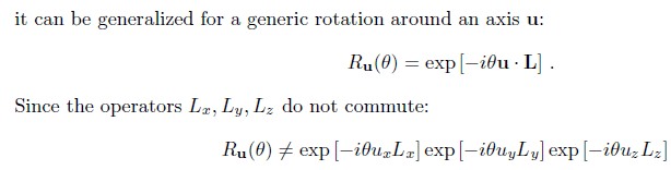

My question is basically this screenshot. So I really have some difficulty in understanding the two equations. I mean how can it not be equal? I understand that rotations are non-commutative, but I really don't see why mathematically these two lines are not equal. Doesn't that violate the properties of matrix exponentials?

In general, if ##A## and ##B## are non-commuting operators, ##e^{A+B} \neq e^A e^B##. You can see this most easily by expanding each side in a Taylor series. The general solution is known as the Baker-Campbell-Hausdorff formula.
EDIT: actually, probably the easiest way to see this is to note that ##e^{A+B}=e^{B+A}## but ##e^A e^B \neq e^B e^A## for noncommuting ##A## and ##B##.

Ah...I see that now...didn't think it carefully enough
Thanks TeethWhitener!
