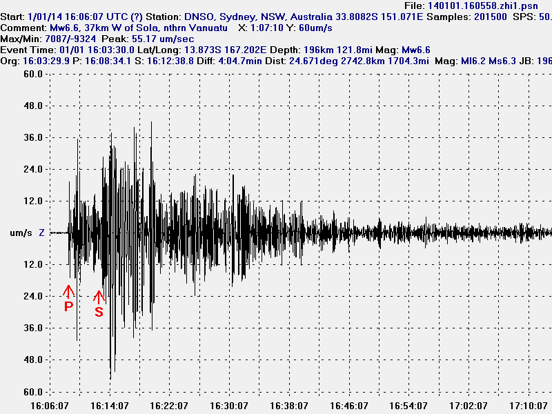

in the early hours of this morning ( my time) 1603Hrs UT i recorded the first sizeable quake of the new year.
This was a Mw 6.6 in the northern Vanuatu Islands. quite a deep event at 196km
the event will still be visible here on my online seismogram for the next ~ 20 hrs from the time of this post.
cheers
Dave

One question: How do you tell the location of the quake from this one graph? Don't you have to triangulate and such with several readings hundreds of miles apart?
hi you litup
that's correct, from one seismogram the location cannot be worked out, only the distance and that is a little variable until the depth of the event is worked out. Increasing depth makes the quake look closer than it really is.
That is because the direct line path from the quake focus is shorter than the path across the curved surface of the Earth from the quake epicentre. The epicentre point is of course the point on the surface directly above the focus.
The info for the quake comes from the USGS WWSSN (World Wide Standard Seismic Network) ( also known as the GSN Global Seismograph Network) and I plug that data into my ( Not created by me!) analysis program to produce what you see above.
The analysis prog, Winquake, is very versatile with full FFT, filtering, depth tables etc adjustments
the recorders don't have to be 100's of km's apart, recorders closer into the event is good for determining locations of local and regional events. Of course for these teleseismic events, the recorders used to locate the event are often 1000's of km's apart

Is triangulation really the only way? I've heard that you can actually estimate the epicenter using only a single seismometer. Determine the direction/angle of the incident p-wave by looking at the various components (tells the direction to epicenter), and then estimate the distance from the seismometer to the epicenter.
Im not aware of anything ... if you can throw up some links to papers I would enjoy reading :smile:
its what I was taught at university, but hey, that was 15 - 20 yrs ago :wink:

Hmm... after searching for a bit, I couldn't find anything in the literature. My information is coming from a plate tectonics professor (seismologist) who made sure to share with us that, in principle the epicenter can in fact be ESTIMATED using only 1 station. We even had to do this on our midterm.
He said that even though it can be done in theory, no one would ever just use a single station to locate an earthquake. It probably isn't all that accurate.
I know that there are many other techniques for locating earthquakes such as double difference [http://www.ldeo.columbia.edu/~felixw/papers/Waldhauser_Ellsworth_BSSA2000.pdf] though the details are mostly beyond me...

I guess it boils down to if there were easier ways than triangulation, they would be getting used.
Since triangulation is what is used in every seismo observatory, its still the best and quickest way to get a location, considering there's no lack of stations from which to derive data.
cheers
Dave
This appears to be a slightly old thread, but I will respond:
Using a single three-component seismometer, it is possible to crudely estimate the location of an earthquake if a p-wave and s-wave are clearly recorded. By computing the polarization vector of the incoming p-wave from the cross-component covariance matrix, you can get the direction back to the source. By computing the s-wave minus p-wave travel time, you can get the distance to the source (think of lightning and thunder). So with distance and direction, you have a location. With a non-homogenous medium, you need to trace the seismic raypath back from the polarization direction, but this is possible, in principle.
