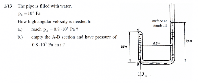

Diagram of a U-shaped tube filled with water, rotating about a vertical axis at the bottom, with a closed top on the right limb; labels show 0.3 m, 0.4 m, 0.3 m, the points A and B, and surface at standstill.
Fluid in rotation
This exercise is quite different from the classic one of fluidi in rotation. Before rotation starts the height in one branch is bigger than in the other, so I do not really know how to approach the problem.
My main difficulty is: how can I determine the constant ##C## in the following expression in this case?
$$p(r,z)=-\rho g z+\frac{1}{2} \rho \omega^2 r^2+C$$
(The frame of reference considered has the ##z## axis towards up and placed on axis of rotation, ##r## is the radial coordinate)
The fact is that I do not really know how to impose the condition for determinimg ##C## as a function of ##\omega## (which is what I want to determine). I think that, once ##C## is determined the rest of exercise is straightforward.
So how can I determine ##C##?

In condition a), what is the height of the fluid in the open section? What is the pressure at its top?
You can't use Bernoulli when the tube is rotated.
Instead:
What total centripetal force is needed to maintain the system in equilibrium when pA = 0.8e5 Pa?
How is this force going to be provided?
