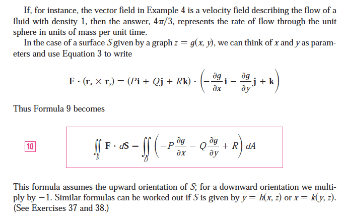

Example 2:[/B]
Flux=integrate -Pgx-Qgy+R of the proj. area on xy plane for z=g(x,y)
Why do my attempt is wrong? The example is using the foundational formula while I use the stock formula from the book, why is there a negative sign difference between the answers? Or is that my formula used inappropiately?
Thanks![/B]

One reason PF discourages the use of images is that they are difficult to edit. On your first line you have the equation ##g = y = x^2##, whatever that means. You are likely using the formula for a surface of the form ##z = g(x,y)##. The surface ##y = x^2## is not that kind of surface because ##y## and ##x## are not independent. The easiest way to represent the surface is ##y = g(x,z)##. In any case, however you did it, your normal vector is in the wrong direction. The ##y## component of your normal vector must be negative.
Likes yecko
but how can we see the direction of normal vector in this formula?
and how to correct it? (simply by adding a negative sign?)
yecko said:
Thanks for pointing out the problem...
I can't tell how you got your normal or what formula you used because you didn't show your work. What I would do is parameterize the surface like this$$
\vec R(x,z) = \langle x, x^2, z\rangle$$and get a normal by ##\vec R_x\times \vec R_z## and take it or its opposite, whichever has a negative ##y## component.
Alright! I believe I've got it! thanks!
