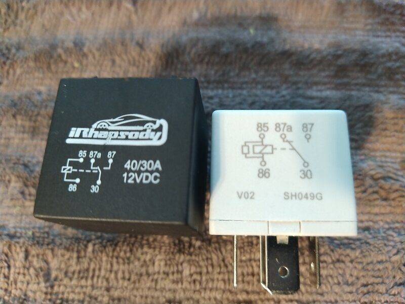

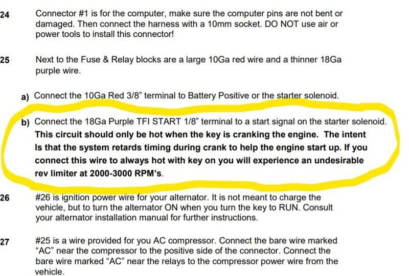

Had an issue with electrical gremlins and blown sensors also 3 ECU's after buying a wiring harness from a Veteran in the industry. Back when this guy started Flyback wasnt even considered and besides the harnesses are installed in kitcars and hotrods built all around the world.All these wiring kits are plagued by flyback emitted from the huge amounts of cheap unprotected diodes they utilize. My ECU expert said I was spiking the heck out of my ECU with flyback due to lack of circuit protection
I research the phenomenon and came up with the fact they weren't using protected diodes in their relays they utilize in a multitude of wiring harnesses for cars and also go into factory built kitcars in massachusettes..
I was having huge issues and have accrued over $1000 in blown sensors and ignition modules and ECU's..wiring harness guy said it was my install skills ... Its his electrical engineering skills that come into question here.
I bought the protected relays and the problems instantly went away as fuelpump relay,horn relay,power doorlocks and power windows also door poppers and trubk popper ,ecu relay,starter solenoid and fuel injectors were the issue causing the flyback through a relay block with cheap chinese relays that are unprotected by a schottky diode.

  • Two automotive relays side by side on a brown textured cloth: a black Rhapsody 40/30A 12VDC relay with pin labels 85, 87a, 87, 86 and 30, and a white SH049G relay with a similar pin diagram.

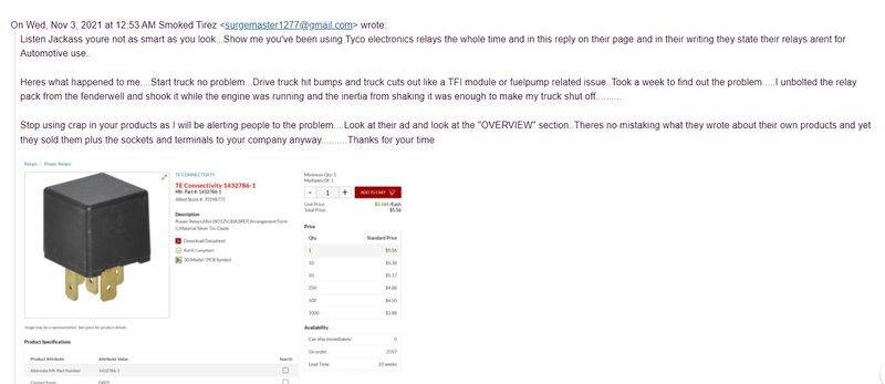

  • Screenshot of a forum email reply with a product photo of a black automotive power relay and a TE Connectivity part listing showing a 5-pin relay with price tiers, specifications and a Download Datasheet link.

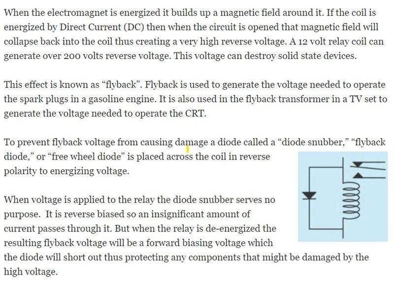

  • Text-only excerpt on flyback voltage; the small inline diagram shows a relay coil with a diode connected across it in reverse polarity, labelled as a diode snubber.

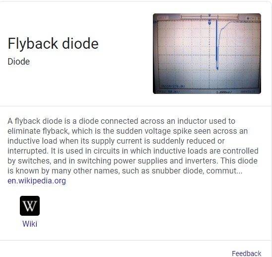

  • Screenshot of a Wikipedia knowledge panel for Flyback diode, with a small oscilloscope photo showing a sharp voltage spike on a grid.

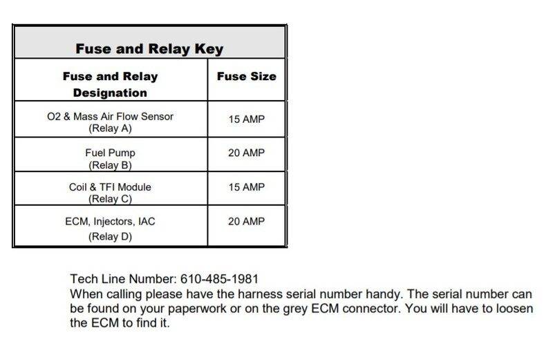

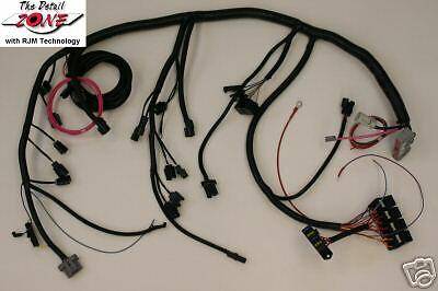

Heres the schematic for the relay..They double up on soma and triple up on another circuit and feed 3 with 1 relay and with a subpar 15 amp fuse too.
They say I am the guy whos creating the issues...
What does the experts say about this?
  • Table titled Fuse and Relay Key listing four fuse and relay designations with fuse sizes: O2 and Mass Air Flow Sensor (Relay A) 15 AMP; Fuel Pump (Relay B) 20 AMP; Coil and TFI Module (Relay C) 15 AMP; ECM, Injectors, IAC (Relay D) 20 AMP.

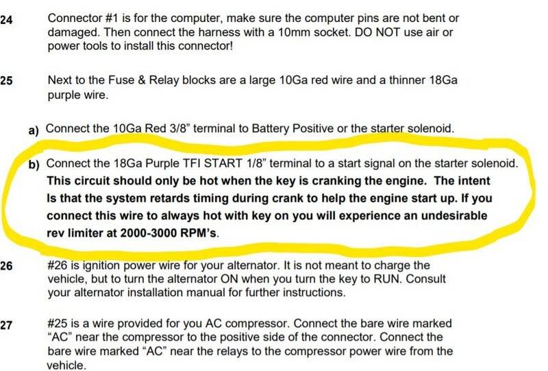

  • Numbered installation instructions 24 to 27 for a wiring harness, with step 25b highlighted in yellow: an 18 gauge purple TFI START wire should only be hot while cranking, otherwise an undesirable rev limiter at 2000-3000 RPM results.

  • Photo of an oscilloscope screen showing a sharp negative voltage spike that decays back to a flat baseline, with a Wikipedia knowledge panel for flyback diode beside it.

When the relay coil is close to the driver on a PCB, it is easy to place a flyback diode. But when they are far apart, the diode needs to be with the driver where the polarity is known, with a twisted pair to power the remote relay coil.
I find this rant a bit on the silly side. If someone in some industry has 'issues' that are causing so many problems in said industry, then come up with a better product. I'm not tell you to go pound sand, just realize that many times problems like these go on for years since not everyone involved is smart enough to realize why the failures are occurring. I have to assume that you are a builder of custom cars/street rods. Since you now realize what is happening, the ball is in your court. Make builds with equipment that doesn't cause the issue. Your reputation as a builder of a quality product will rise.
Also realize that many many automotive relays have no flyback protection. The circuit that drives them is taking the task of suppressing the spike generated by the falling field in the relay coil. A flyback diode built into a relay can be a risky thing for the amateur to be messing with since a reversal of polarity will fry the diode and may blow the output device that is driving it. Coming on here explaining about flyback as if it is a new thing is like me coming out with big news about how people get wet if they don't come in out of the rain. If you couldn't tell, I used to work in the automotive electronics industry.
