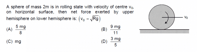

Using the fact that the sphere is in equilibrium in the 'y' direction , the force exerted by the floor N = 2mg .
Now , if I consider the lower hemisphere then , vertical force exerted by top hemisphere + weight of lower hemisphere = Normal reaction from the floor .
This means , vertical force exerted by top hemisphere on lower = mg
Should this be the total force exerted on the lower hemisphere ?
Thanks

Yes, the sphere as a whole is "in equilibrium in the y direction" since the center of mass of the sphere has no acceleration.
However, does the center of mass of the lower hemisphere have any acceleration?
It has centripetal acceleration ω2r ( r=3R/8) directed towards the center of the sphere i.e in +y direction (upwards)
Taking + y to be upwards , 2mg - mg +R = mω2r , gives R = 5mg/8 downwards i.e option A)
Is that ok ??
Is that ok ??
Yes, I believe that's all correct.
Likes Vibhor
Thank you :smile:
