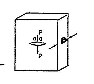

1) Consider a centre crack specimen subjected to a wedge load a shown in the figure:
https://www.physicsforums.com/attachments/centre_crack_wedge_load-jpg.112584/ In such a case the stress intensity factor DECREASES with the INCREASE in crack length

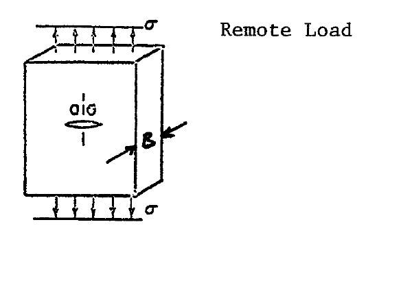

2) Now, consider a centre crack specimen subjected to a far field stress as shown below
https://www.physicsforums.com/attachments/centre_crack_far_field_stress-jpg.112585/ Here the stress intensity factor INCREASES with increase in crack length

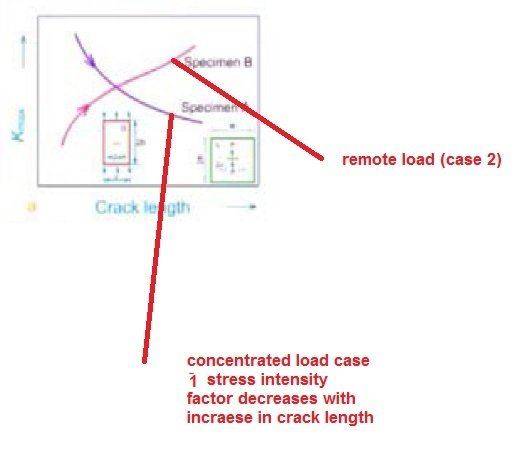

Now, my question is,
Case 2 is intuitively appealing / understandable since with increase in crack length we move towards the fracture toughness of the material thus stress intensity factor increases with increasing crack length
I'm not able to intuitively understand case 1. With increase in crack length the stress intensity factor is decreasing and in fact with increasing crack length we are moving away from fracture toughness of the material?

Here's how I reason this out, although you may not find it satisfying:
First, let's note that you're focusing on the ##\frac{1}{\sqrt{\pi a}}## and ##\sqrt{\pi a}## factors, not on the geometric factor sometimes denoted by ##Y## that also appears in the stress intensity factor that distinguishes the infinite-width case from the finite-width case.
In Case 2, there's essentially no strain energy stored in the specimen directly above and below the crack, because the crack surfaces are stress-free away from the tip. Therefore, if the crack grows slightly, it will relieve the strain energy in the material above and below the new length segments. Reducing energy is what drives spontaneous processes, so the stress intensity factor increases. In addition, for finite plates, the geometric factor increases with increasing crack length because the load is being borne by a smaller amount of remaining material.
In Case 1, nearly all of the strain energy is stored directly above and below the crack, because the concentrated (or point) load is applied in this region. The regions to the left and right are largely unaffected. But for a larger crack, less energy ends up stored above and below the larger crack because the point load is distributed over a larger area, so the stress intensity factor for an infinite-width plate is lower, (i.e., the difference between Case 2 and 1 is ##K=\sigma\sqrt{\pi a}## vs. ##K=P/\sqrt{\pi a}##, respectively, for the infinite-width plate). With a finite-width plate, the crack may be so large the stress in the left and right regions is no longer negligible—after all, these regions must counteract the point load. This transition corresponds to a sharp increase in the geometric factor such that the stress intensity factor (for the finite plate) increases again with increasing crack length (see Fig. 8 http://www.colorado.edu/MCEN/MCEN4174/index_files/lectures_files/Stress_Intensity_Factors.pdf, noting that although the caption says "Stress-intensity factors", the y-axis is labeled as the geometric factor).

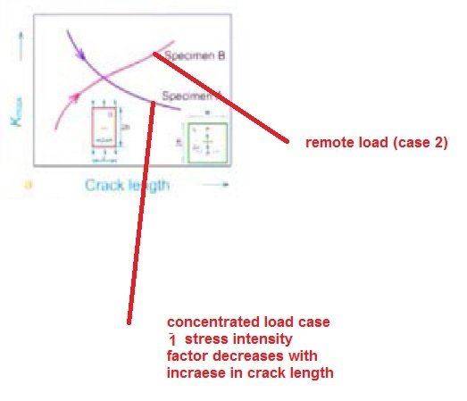

4) I am asking what is the physical reason that why is the stress intensity factor decreasing in case 1 (only the point load acting)
5) In case 2, the stress intensity factor increases as crack length increases. This is intuitively fine to imagine
6)But in case 1, the stress intensity factor is DECREASING with increase in crack length. This is not intuitive

As 256 bits notes: this is a horrendously horrific subject, meant for a select few. In fact, it is nearly incomprehensible. I am suggesting another book below for the esoterically inclined. In that book, in the paraphrased words of Winston Churchill, “never before has so much been written about so little, to be read by so few”. However, it does a good job on energy increase and decrease in the first two chapters. Let me try to summarize my interpretation.
First of all, the case of applied far field stress it is indeed easy to show increase in stress intensity with increase in flaw length, until a critical length is reach and catastrophic failure occurs (unstable crack growth).
The stress intensity is proportional to (stress)(a^ 1/2).
Now look at the point load case, so called wedge load. Here we are talking LOAD not STRESS; the stress is very local at the crack tip. Now the units of stress intensity have to be consistent; you need to compute stress from the wedge load over the crack length, unlike the far field stress which is uniform over the whole cross section. For a wedge line load, F, where F is the load over the width of the plate (force per unit length), stress intensity varies as P/ a ½ which results in a DECREASE in stress intensity with increase of crack length. For a wedge POINT load, P, where P is in force units, stress intensity varies as F/ a^3/2 , which also results in a DECREASE in stress intensity with increase of crack length. Note the consistency in stress intensity units. Thus as crack length increases stress intensity decreases. A plot of load or line load vs crack length will thus show a negative slope; for failure to occur slope has to be positive and crack has to reach critical. Thus for point and line wedge loads, you never have failure for an infinitely long plate. On the other hand, for far field stress, slope is positive so you can have catastrophic failure at critical crack length. Note that if both far field and wedge load are both applied, you add the stress intensities; the slope starts negative from the near field stress then goes to zero as the far filed stress overtakes the point load stress, then goes positive slope until failure.
I agree it seems counterintuitive that the stress intensity should decrease, but the equations from the energy formulation do not lie. And test results prove this. In laymen’s terms think of the wedge load as constant; for bigger flaw area, stress is lower, unlike the far field stress which is constant stress over the entire section.
The equations to prove this are complex using Green’s functions and energy theory. You can find them in first two chapters of Lawn, Brian R, NIST fellow, “Fracture of Brittle Solids”, Cambridge University Press.As an aside a practical application of a wedge load residual stress produced by a diamond indenter when combined with a far field stress shows the same phenomenon; a decrease in stress intensity until applied stress overcomes and failure occurs. Here, in spite of the initial decrease in intensity, strength is reduced by a factor of two. You can read all about it in the book I referenced earlier by Pepi, J “Strength Properties of Glass and Ceramics”, SPIE Press
