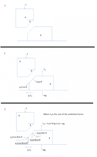

Component A is pushed vertically down with a known force F into component B. The angled surface of B is parallel to the angled surface of A. The contact between A and B is rough and so is the contact between B and the ground. The coefficients of friction are known and so is the weight of component B.
Determine the angle at which component B is about to slide.
See attached image.
I've drawn the problem in frame 1. In frame 2 I've drawn a free body diagram of component B. In frame 3 I've resolved these forces into X and Y directions. I assume I then write equations for these two directions and determine the angle which makes the net force in the X direction equal zero.
Could someone please advise if I've identified the forces correctly and if this approach is correct, thanks!

What stops component A moving left?
In the system that this is from, component A is constrained such that it's only able to move in the Y axis.

So include a force for that. It is relevant.
So that's going to be a normal force on the left side of A equal to the sum of all the resolved forces that are acting in the -X direction i.e. μ1Fcosθ sinθ, and I'll need to include this in the force balance?

Yes, it will provide the horizontal balance for A, but since it will affect the normal force between A and B do not assume it is equal to μ1Fcosθ sinθ.
Hm, will there additionally be a Fcosθcosθ term to add to that? I've got this from the X direction reaction force at the interface between A and B.

I don't know how you are getting that. I don't think it is right.
You can avoid having to worry about the horizontal force on block A if you just look at the balance of the vertical forces on it. What equation do you get for that?

I've tried doing a force balance for block A first of all. I've written it out in terms of forces normal and parallel to the contact surface (rather than breaking these down into X and Y components.
http://i.imgur.com/TL0g7fr.jpg
If you think this looks somewhat correct I'll go on and do a free body diagram for B. :smile:

The free body diagram for A should not know anything about the friction between B and ground.
Trust me, it will be a lot simpler if you just look at the vertical forces on A. Resolving normally and parallel to the surface with B will only add more unknowns and equations.
