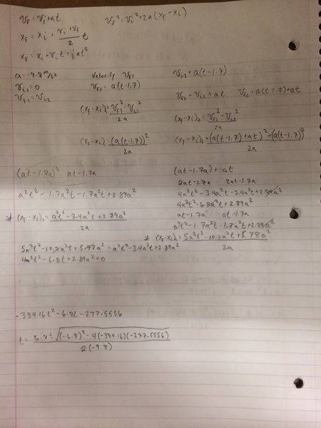

The quadratic at the bottom is my result which didn't provide any real answers. I attached a picture of my work. The equations I can use are written at the top of the page.

We can disregard that attempt I solved an equation wrong and it escalated from there.

Reasonable. So we'can use the two equations you listed, right?
For the first half you can still write
d/2 = g/2(t-1.7)2, because that is your 2nd relationship (with Vi = 0).
And you know that half way the velocity v' is g (t-1.7) because that is your 1st relationship.
For the second half you can now write
d/2 = v' * 1.7 + g/2 1.72 because that is your 2nd relationship (with Vi = v').
pick up d/2 from the first half and pick up v' as well:
g/2(t-1.7)2 = g (t-1.7) * 1.7 + g/2 1.72
multiply left and right with 2/g ( number, no problemo)
(t-1.7)2 = 2 (t-1.7) * 1.7 + 1.72
If possible, avoid numbers until the last moment. Perhaps things cancel

In that last attempt I left the acceleration due to gravity out until the end. The other numbers are from expanding (t-1.7) and such. When I get off of work I'll sit down and re try the way you just posted BvU. I'm just not sure why I don't see the relationships between the first and second halves using the kinematic equations.
Basically you need to get rid of d and v'. v' is the final speed of the first half and at the same time the initial speed for the second half. You 1st relevant equation helps you get rid of v' and your second does the same for d. Originally there were three unknowns (t,d,v') so you needed three equations.
ehild's post #11 is actually only making use of your 2nd relationship and doing so twice in a very smart and very economic way (much easier to look at first half and whole instead of at first half and second half, or at whole and second half). He only needs 2 equations because he doesn't have v' in there.
So his approach is both legal and economic. Laziness pays out twice: you have less work and less chance of errors. Some people even confuse smart with lazy :-)

Solved it. Thanks to everyone that offered advice.

I solved the problem symbolically. I just had an arithmetic error at the end. I finally figured it out.
