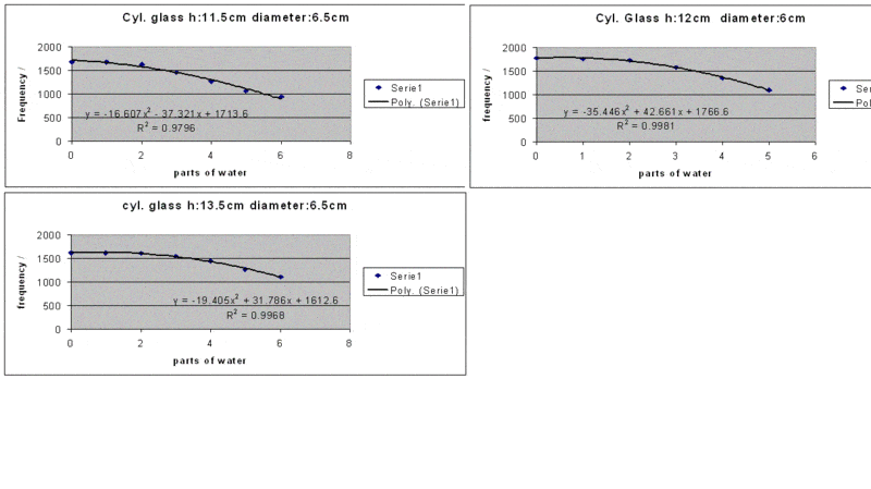

The mass of a harmonic oscilator affects the frequency as 1/SQRT(m), this would mean that a frequency of 1000 Hz with 1 part (of say water) in the glass should be lowered to 500 Hz with 4 parts (of water) in the glass, but in my wine glass (of a typicas wine glass shape) it is only lowered to about 750 Hz. the shape og the glass might affect the effective mass, so maybe I should try disserent shapes. - other ideas ?

It seems to follow this behavior for cylindrical glasses of same material and thickness.
Frequency in Hz
Any ideas ?
(i have tried to attach 3 graphs...first time- hope it works)
- ZeroGravity

The glass is what is vibrating, I don't know the modes but they're probably very complicated. My guess is the water level is creating a boundary condition on the glass, below this level the oscillations are damped, and above they are undamped, so maybe you are imposing a node at the water level, and therefore changing the maximum wavelength of oscillations?
I suggest trying a simpler case, eg. a string from x=0 to x=l where for some a,0<a<l, in the region [0,a] you have undamped motion and for [a,l] you have damped motion, then see what the conditions are at x=a.

As others have said, it is the glass that is vibrating and producing the tone, not the air inside.
I did a study on something similar to this a while back and it seems the fundamental vibration occurs when the rim of the glass vibrates such that there are 4 nodes and 4 antinodes spaced equally around it.
The glass needs to vibrate in and out, and as such, placing water in it means that there is a greater amount of mass to be moved than if you had air in it. This results in the fundamental frequency being reduced. The more water, the more mass needs to be moved.
